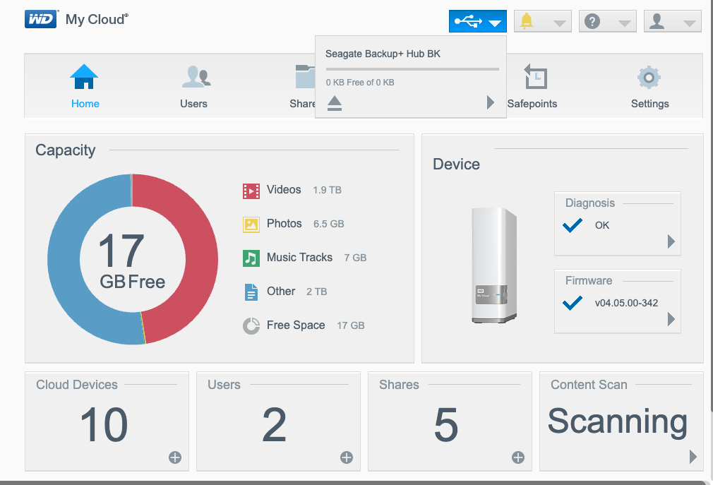

mikehalloran wrote: ↑Sun Oct 22, 2023 3:19 pmI'm trying to connect an external USB Drive to my WD My Cloud for Time Machine Back-ups over my local network. The only drive it will recognize is a "Seagate Backup+ Hub BK" formatted Mac OS Extended (Journaled) but it shows '0 KB Free of 0 KB" space available and I'm unable to share the volume. How do I need to format an external USB External Drive so that it will is recognized be WD My Cloud?

Many thanks. The drive I actually want to us is a reconditioned DELL EMC Exos X18 that I picked up recently but it shows 0KB Free of 0KB storage available (also no partitions show up in Safepoints). I'll try contacting WD and see if I can get this working.WD MyCloud devices support only one Time Machine Volume per device. Otherwise, you can pretty much configure as you like. Their manuals can be somewhat confusing.
I recommend calling and have someone walk you through it. 1 (855) 493-7867. They can look at your screen which makes things go faster

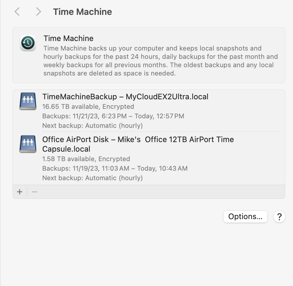

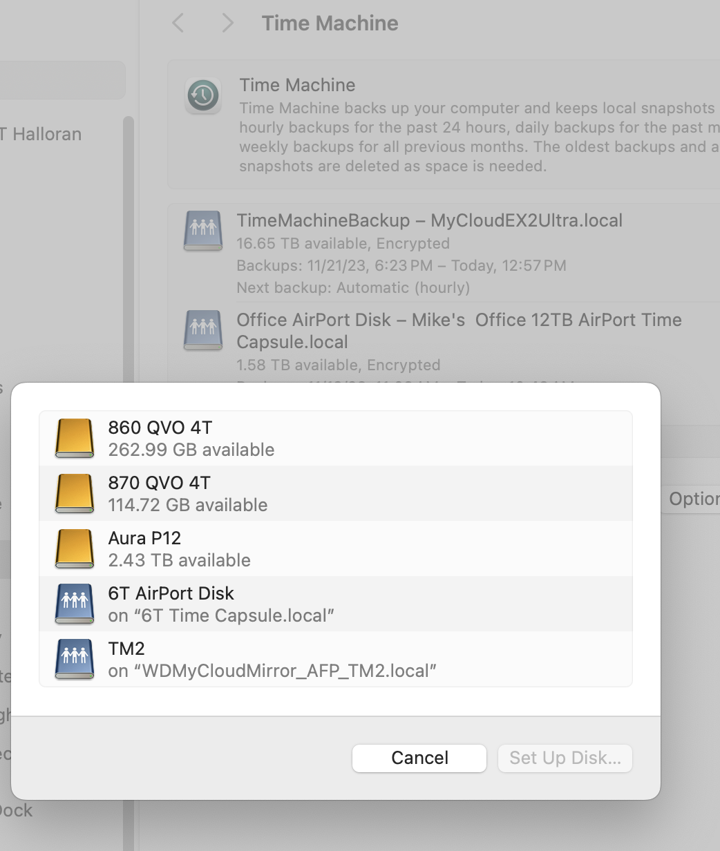

Look at my Locations sidebar: the three circled drives are the TM drives available to this Mac over Ethernet as you can see, I'm only backing up to two at the moment but that will change soon. None of them show up on the desktop unless I force them to be double-clicking. If you can get the Volume on that Qnap to show up there, TimeMachine should see it when you open it and try to add a backup volume. Be sure to check the box to encrypt your backups, otherwise, certain data will not be backed up.

I'm on the phone with WD support right now and they are telling me only Western Digital Drives formatted HFS will work? Is this what you are using?

Yes, also tried to see if I could get the Exos 18TB USB attached to My Cloud to show up as a network volume in the finder but it does not. I may just give the Qnap enclosure a go as I have already spent several hours trying to get different USB drives to show up on my network connected to My Cloud with no joy so far and I need to get back into some right brain activity (like actually making musicmikehalloran wrote: ↑Wed Dec 13, 2023 1:18 pm If you can get the Volume on that Qnap to show up there, TimeMachine should see it when you open it and try to add a backup volume. Be sure to check the box to encrypt your backups, otherwise, certain data will not be backed up.

I was finally able to get Time Machine back up working with a USB drive connected to a WD My Cloud by using a Western Digital Ultrastar HDD formatted Mac OS Extended Journaled (WD tech support was right, you do need to use a WD drive!). Plugged it in and it worked just fine and as we speak my Mac Studio is happily backing up to it. Thanks everyone for all your support (especially Mike
