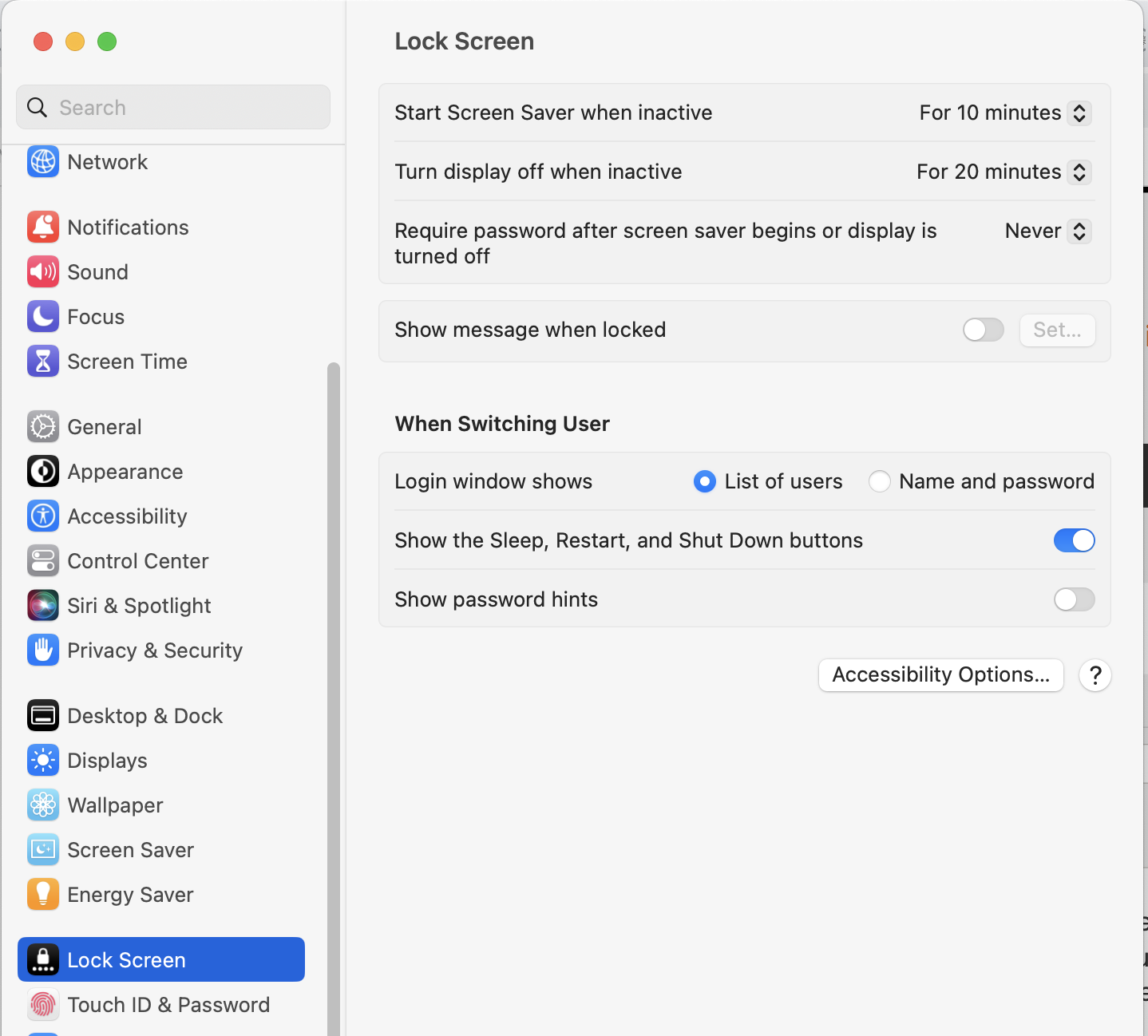

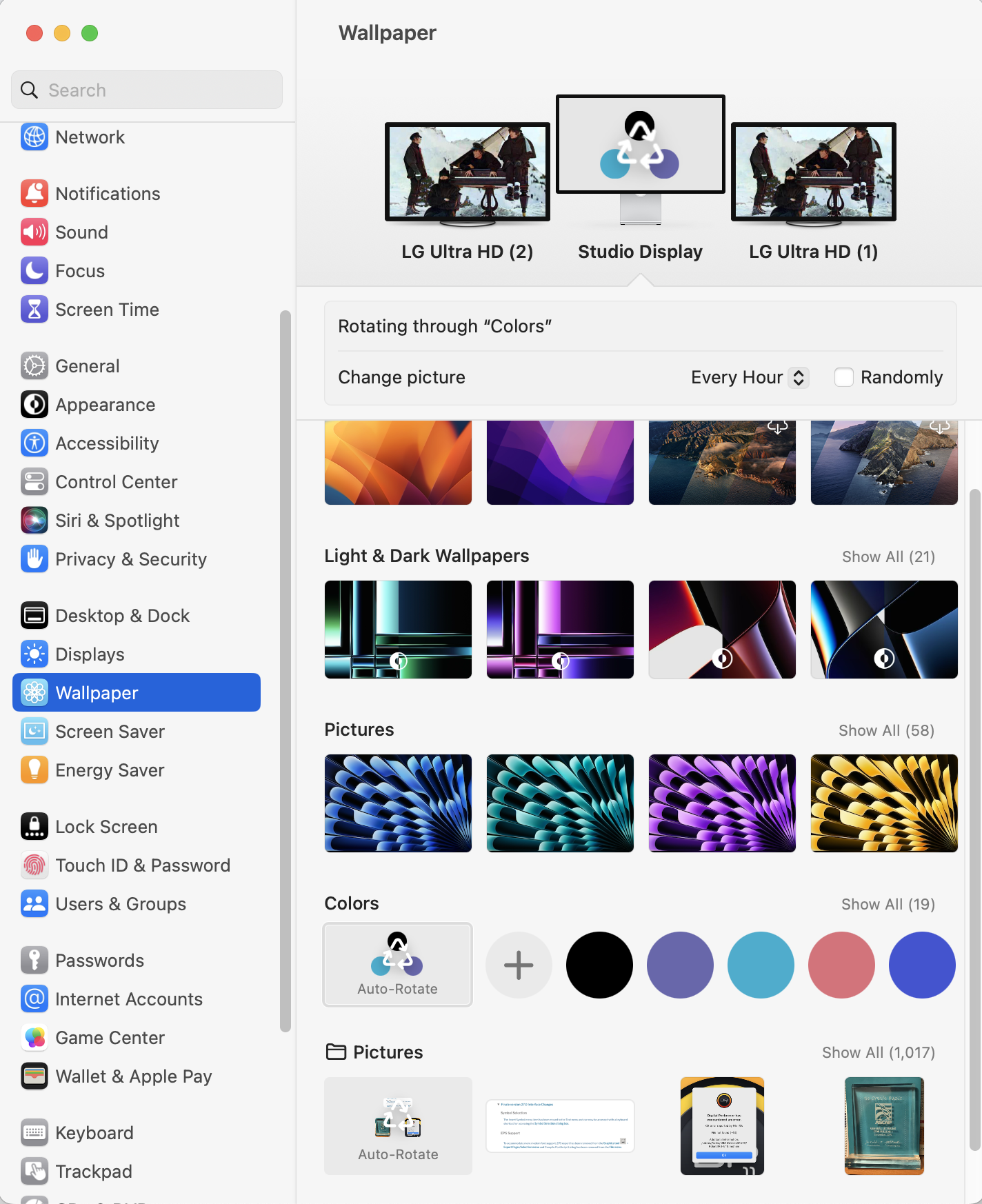

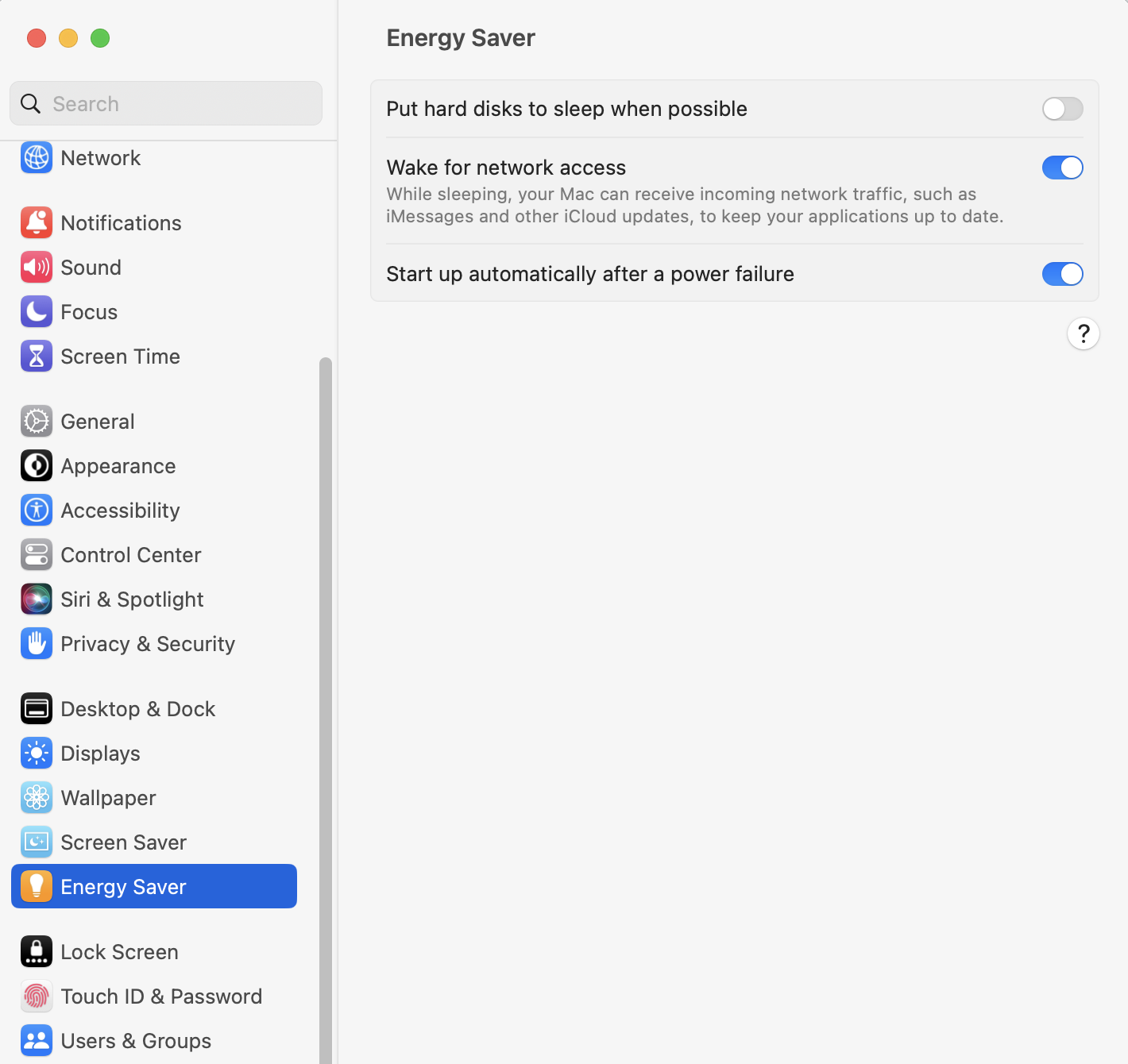

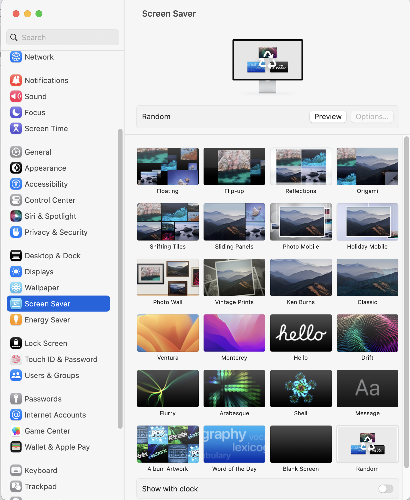

On my iMac Pro, I could count on that happening when rebooting after a Safe Boot or booting into Recovery. Sometimes, I had to reboot twice to get my wallpaper back.
I was having multiple monitor problems with my new M2 Studio. It didn't remember which screen was the center. Also, though my Studio Display would go to sleep as it should, the LGs would not. My LG 4ks were connected via DisplayPort to USB-C cables on my iMac Pro. Switching to 4K@60Hz HDMI cables (one HDMI–HDMI; the other HDMI–USB-C) solved most of the problems including those two. Apple Engineering has no clue as to why but I am hoping that Apple Support now has this in the database since I had to demonstrate this in person in Cupertino (thank goodness the Studio fits in a shoulder bag) before anyone would believe me.
What's left?
Sometimes the Left monitor that is connected to the HDMI port (HDMI–HDMI cable) will be distorted on waking but a reboot takes care of that. Other times, the L and R screens will swap places — again, rebooting fixes this.
You can't tell an Apple Silicon Mac never to go to sleep directly but you can indirectly and allow certain services to run in the background. The monitors, however, can be controlled. All this is done through settings on six different screens. Fun, huh?

That's accessed through the Advanced button from Displays which is why I circled it. It's not available through Energy Saver as one would expect.James Steele wrote: ↑Wed Nov 22, 2023 3:46 pmFor whatever reason I don't even have the "Prevent Automatic Sleeping..." option.mikehalloran wrote: ↑Wed Nov 22, 2023 1:23 pmYou can't tell an Apple Silicon Mac never to go to sleep directly but you can indirectly and allow certain services to run in the background. The monitors, however, can be controlled. All this is done through settings on five different screens. Fun, huh?
I forgot to include Lock Screen as one of the control panels that affects this. I spent days with Apple Support on the phone before guessing that my big issue was DisplayPort vs HDMI and going to Cupertino to show them my guess was right. Ok, the mothership campus is a three mile drive...
Since this board allows only three uploads, I've edited my previous post so that I can display all six screen shots.
