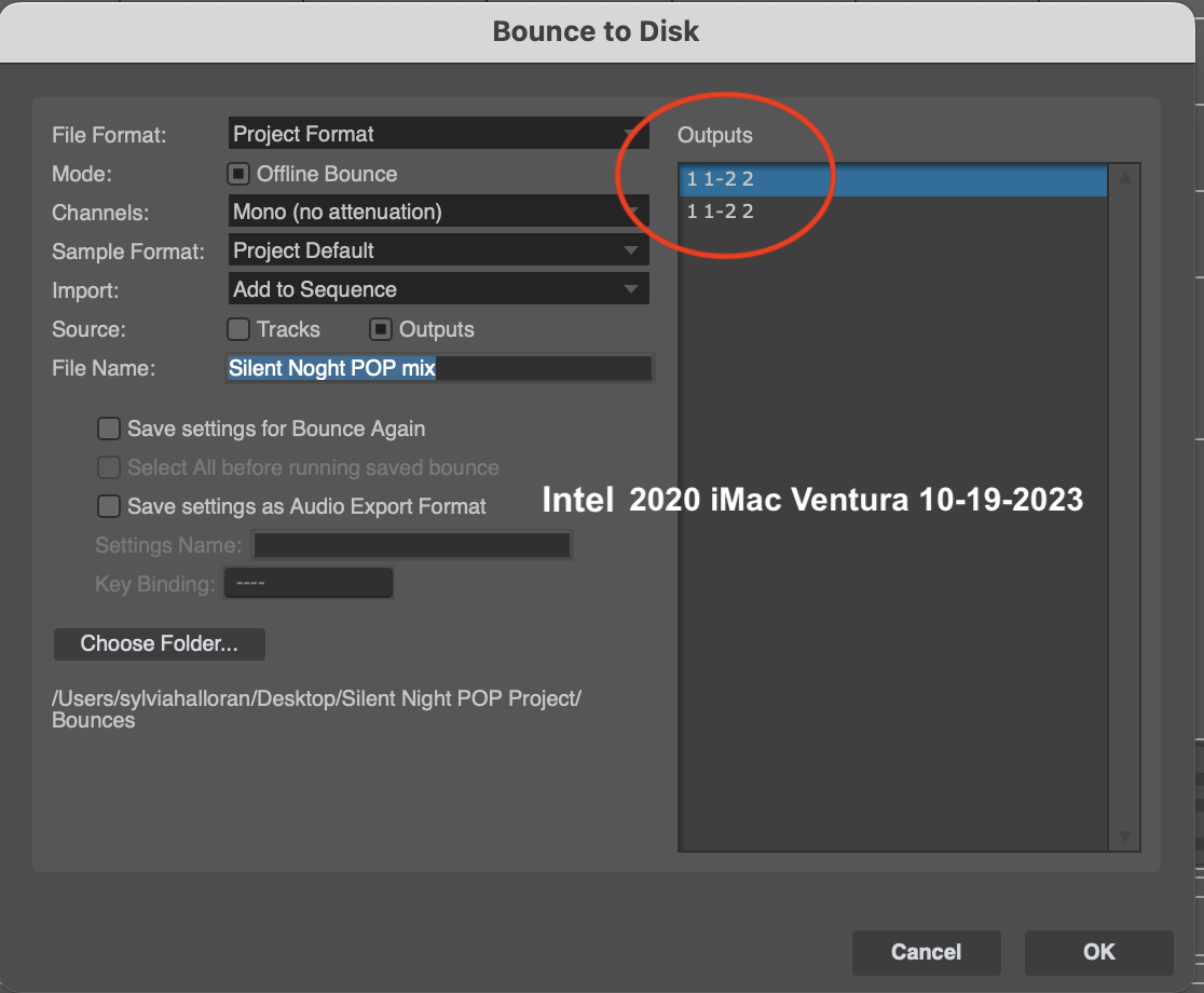

I don't know why you believe this is an Apple Silicon vs Intel issue. It's not. Nothing I can find on motu.com or in the release notes indicates that it's anything other than Ventura (and now Sonoma). I have yet to begin a project on either of my Apple Silicon Macs.
This is a file I created on my 2017 iMac in 2022 over Monterey. I no longer have a Mac on Monterey but pulled this from the archive and loaded it onto three Macs. All three Macs are running DP 11.23 and I created these screenshots this afternoon.
Before I went to Ventura in January 2023, my BTD window looked like this:
2012 MacBook Pro Catalina 10-19-2023.png (67.02 KiB) Viewed 4745 times
After rebooting and firing up DP, they look like this.
2020 iMac Ventura 10-19-2023.png (129.55 KiB) Viewed 4745 times

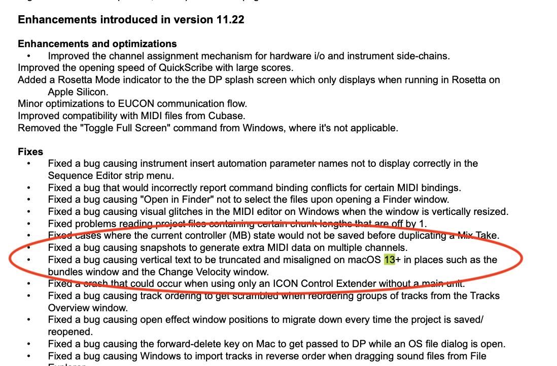

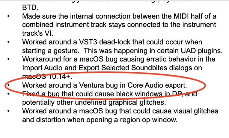

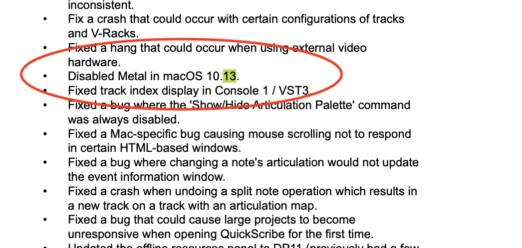

These are the only mentions of Ventura and macOS 13 in the DP Release Notes. Nothing about Intel vs Apple Silicon:
Screenshot 2023-10-19 at 3.05.05 PM.png (111.97 KiB) Viewed 4736 times
Screenshot 2023-10-19 at 8.24.46 PM.png (228.48 KiB) Viewed 4730 times
Screenshot 2023-10-19 at 8.28.34 PM.png (136.72 KiB) Viewed 4730 times

mikehalloran wrote: Thu Oct 19, 2023 8:14 pm These are the only mentions of Ventura and macOS 13 in the DP Release Notes. Nothing about Intel vs Apple Silicon:
Thanks for the additional info - after a bit of further digging on our side I can shed a bit more light on the situation but unfortunately I don't have a way of fixing it directly. However, I can at least try to explain what leads to this behavior.
The names of the outputs in the BTD windows are pulled from the Bundles window. Each of the bundles in the Bundles window will default to naming itself based on the outputs it is assigned to, unless a custom name is set. It looks to me like your project contains two bundles, neither of which has a name set, which causes it to pull from the assigned outputs.
In the built-in empty document template, there is one named bundle ("Main Out L-R"). I'm assuming based on your screenshots that you've modified this by changing the document(s) in question and/or using a custom new document template with un-named bundles. What this means is that your bundles are now pulling from what the audio driver is returning.
The reason I had initially mentioned Apple Silicon was because I was primarily seeing this issue with the built-in audio driver on Apple Silicon devices, and found it to be working fine when I quickly checked this on an Intel Mac running Ventura. I've since managed to identify at least one Intel Mac running Monterey which also exhibits this issue, which means it's not isolated to Apple Silicon nor is it a Ventura-specific issue. The bug really is just that certain Macs do not return the correct metadata when using the built-in audio. If you have another audio output, you could confirm this by choosing that (from Configure Hardware Driver) and checking that those output names change - for example, when I tried connecting to my HDMI monitor's audio out, that description changed to the name of my monitor.
If you're using a custom template, you should be able to assign a name to those bundles in your template once + save that new template as your default, and then make new projects from that template. Subsequent projects made from that template should be named correctly, and that name should persist regardless of the audio interface as the bundle name will be what shows up in the BTD window. This won't work for your existing projects, but renaming the bundles as I mentioned before should also stick. (I know you mentioned it's not a big deal, just wanted to offer that possibility in case you wish to try it).
Hope that helps/clarifies things!
Edit to add: The changelog entries you had pointed out are unrelated to this - only speaking for myself, of course, but I was not aware of this issue previously.
I have 11 audio outputs including 6 physical and 5 more virtual. Some do change the name; others do not but none of those I use do.
Knowing the issue makes it relatively unimportant but it does confuse people. There are other problems that should have higher priority.
