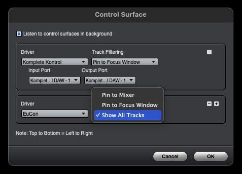

3) The best option (for now) if you NEED to run Eucon 2023.6 on your Apple Silicon Mac. Go to your Control Surface Setup and choose "Show All Tracks" from the drop down menu as shown in the screenshot.
This keeps the tracks on your control surfaces static. You might also try "Pin to Mixer" but if you are in the Mixing Board and you rapidly show/hide tracks (like switching between "All" or "Play Enabled" with a hotkey, you *might* trigger a crash. This still won't protect you from project load crashes, but once the project IS loaded, you should be okay.
