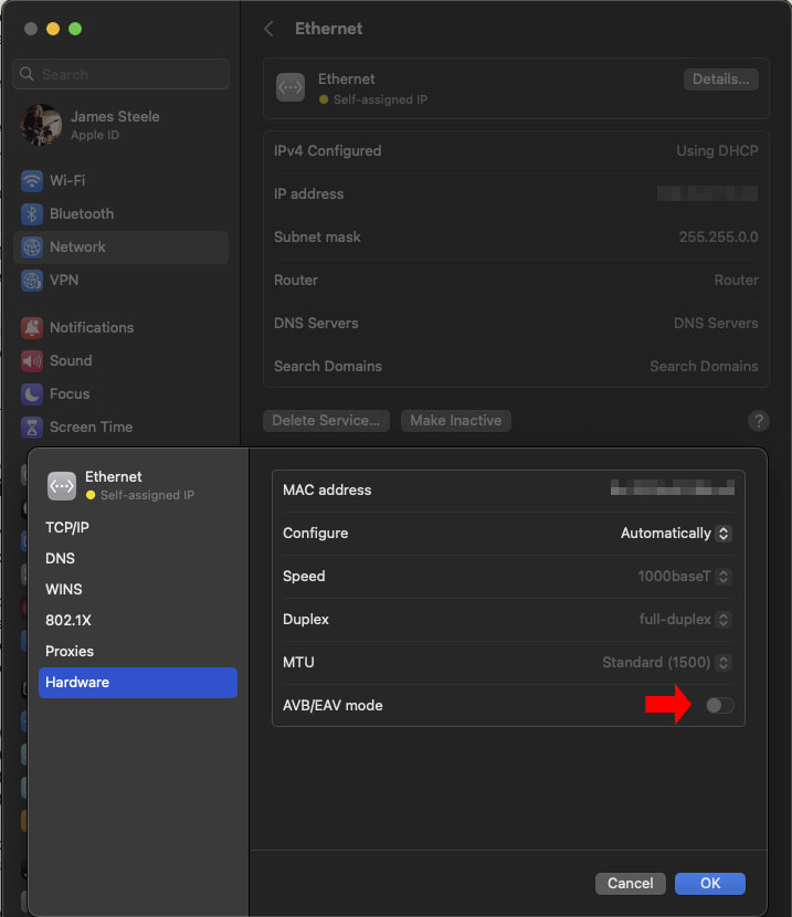

Posts: 22790
Re: MOTU 24AI - limited to 24x24?
One interesting tidbit I picked up on another forum somewhere is that with Apple Silicon computers, you have to enable the Ethernet port to use AVB. There was someone with an issue where his Mac wasn't communicating via the Ethernet port with an AVB device and he had to go in and toggle this setting (shown below with red arrow):
It's in Settings > Network > Ethernet > Details
Just passing this along in case it's useful... not necessarily pertaining to this situation, but it's good info I wasn't aware of before.
