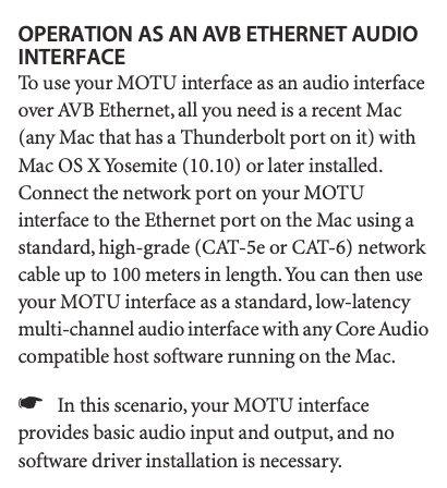

Correct me if I'm wrong, Mike, but isn't the issue when connecting a Mac directly to the Ethernet ("Network") port on a MOTU interface like the 24Ai is that you have to use a Mac that is new enough that either the hardware or OS (not sure) is new enough that it supports AVB directly? My understanding is it's not really plain vanilla Ethernet... but AVB... so not just any Mac will do.mikehalloran wrote: ↑Sat Jun 24, 2023 3:53 pmGigabyte Ethernet has been the minimum standard for over 20 years. Although some Macs and PCs support 10G Ethernet, there's no mention of this in the 24AI specs or documentation — and you know it would be there if supported.
Hold on! I just now looked though the 24Ai manual and found this:
So the way I read this is it's not so much the OS that's an issue. I imagine most users these days are using Yosemite or newer. You just need a Mac that supports Thunderbolt. Apparently those models have an Ethernet port that is compatible with AVB.
I'm still digging to see what the limitations are of doing it that way. Couldn't find it in the 24Ai manual, but I'm pretty sure HCMarkus is right and there is a limitation on the sample rate and also some latency when compared with USB. I use mine as an AVB expander to my 828es which is connected to my Mac via TB2.

I think it's more about the OS than the actual Mac hardware James, but I could be wrong.

If you look at the requirements, it must be a Mac that has a Thunderbolt port. Sounds like a hardware requirement to me. Unless MOTU is using the presence of a TB port as an arbitrary indicator as to what constitutes a “recent Mac.”monkey man wrote:I think it's more about the OS than the actual Mac hardware James, but I could be wrong.

Perhaps. I guess one way to know is put the same approved OS on a Mac with TB and one without and see if it still works on the one without. Why even mention the TB port at all? Just mention minimum operating system?

Yeah... but this was in MOTU's documentation... not Apple's.monkey man wrote: ↑Thu Jul 06, 2023 9:05 pm Only possible (and obvious) reason I can think of is to encourage sales of new Macs.
