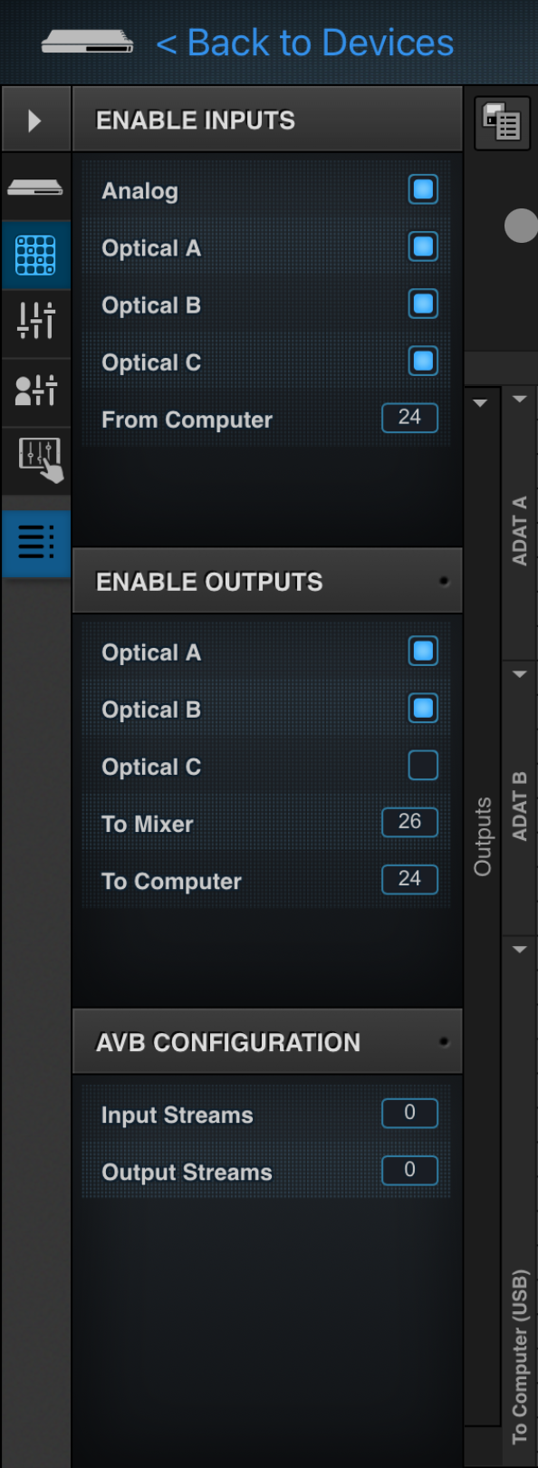

I recently bought a MOTU 24AI to use with MacOS / iPadOS. The problem is, I appear to be limited to 24 in and 24 outs. I have a couple of Behringer ADA8200s connected to use as outputs but it won’t let me use them as additional 8x ins.
I am using the latest version of MacOS and iPadOS on USB. Every single app only shows 24 in 24 outs. Is there anything I can do? The MOTU website says it should do 72 channels including the optical IO.
Is there something wrong in the setup? Can anyone advise me? Thank you!

I can’t see how it’s possible to increase beyond 24x24.
When I try to change the values of “from computer” or “to computer” beyond 24, they simply revert back to 24.
Am I doing something wrong? Or is there another setting I need to use? Have anyone actually achieved this with a MOTU 24AI?

I’ve read the manual, tried every options I can see. I can find no way to have more than 24x24 over USB on this thing. What a pain! Please, someone tell me I’m wrong.

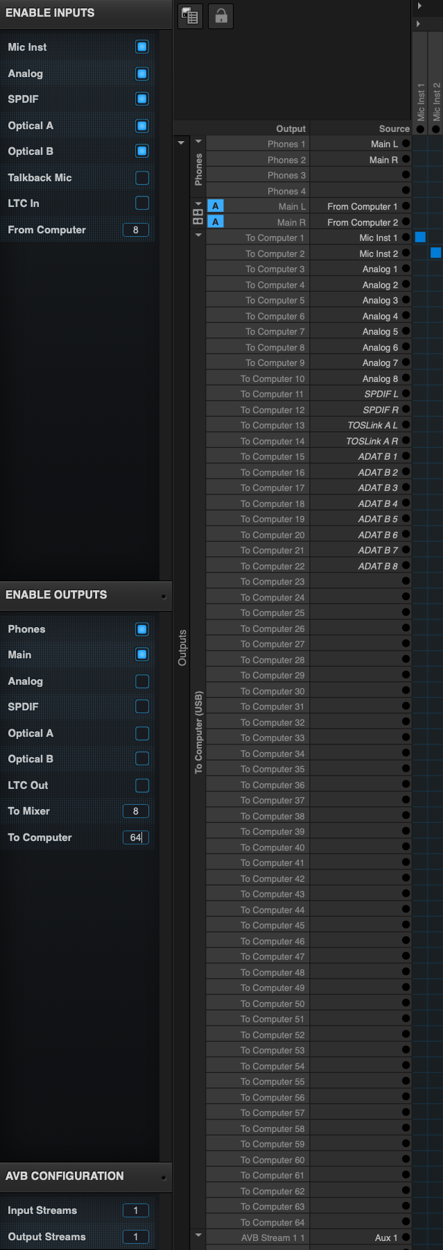

I can confirm 64 channels from my 828es connected via USB 3 card in my 2009 modified Mac Pro. See attached screenshot. I didn't test to the point of passing audio, but when I type "64" in the Enable Outputs > To Computer field, then hit Tab or Enter buttons, I get what the screenshot shows.

It appears to be acting as if you have a 4x sample rate selected (176,192). That would be a no go on your ADA8200s anyway - try 48k.
