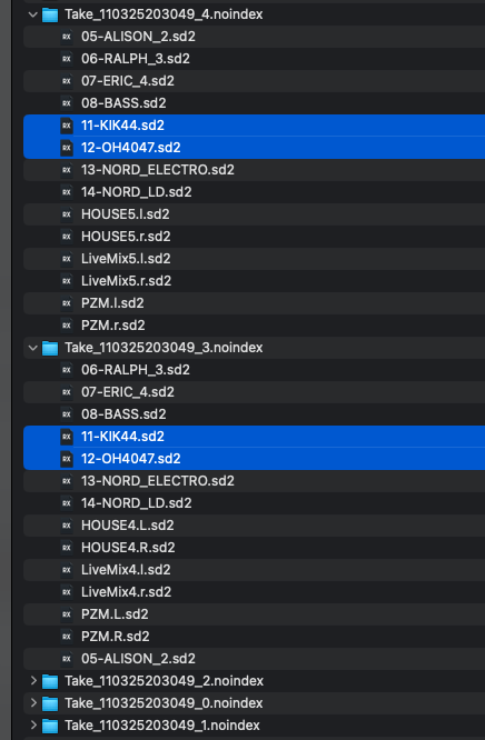

The files are not in the audio files folder- there are 5 "Take" folders (originally recorded in the Metric Halo MIO Console on location in 2011), and the contents of each folder is 14 files with the same name as in every other Take folder, so I cannot just move them to the Audio Files folder. (The attached image "Finder"will give you the idea, I've highlighted the tracks that DP won't find). ALL but 2 tracks are connecting properly via the path. If I could go back in time 12 years, I would have renamed the original files at the time!!)

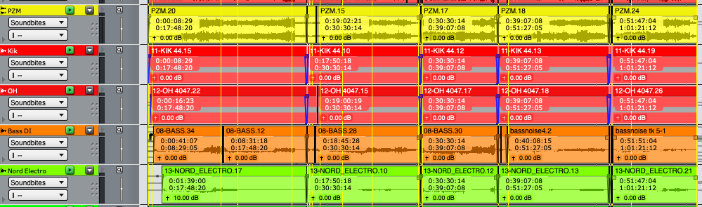

Can't just drag them in, this session is edited. (Attached image "tracks")

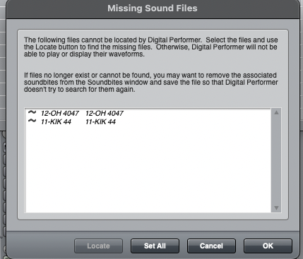

Because the "Missing Sound Files" dialog box is confused (attached image "Missing Sound Files"), if I navigate to and select any of the like named files, ALL of the soundbites in that track fill in from that one file.
