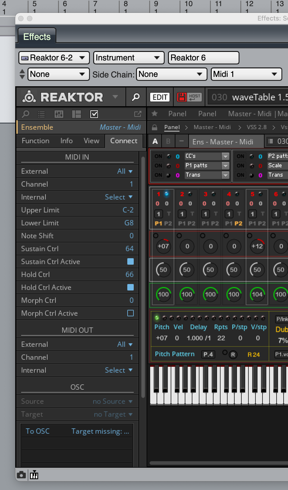

This is how I use a VST Reaktor Sequencer in DP to route MIDI to another source. Make sure you are in MULTI RECORD. It can be done, and be patient.
Screen Shot 2023-04-28 at 12.50.18 AM.png (309.85 KiB) Viewed 1408 times
Screen Shot 2023-04-28 at 12.51.01 AM.png (166.62 KiB) Viewed 1408 times
Walbertus
Posts: 24
Joined: Thu Mar 01, 2012 8:39 pm
Re: MIDI plug ins by other developers
Post by Walbertus »
Thanks to everyone for their potential help. I will study these things. It took me by surprise that something as basic as connecting MIDI should be so difficult.

Walbertus
Posts: 24
Post by Walbertus »
[/quote]
Multi Record was the solution !!! Thank you so much !!! :dance:
DP11, OSX 10.13.6, Mac Pro
Posts: 4507
Walbertus wrote: Fri Apr 28, 2023 10:41 am This is how I use a VST Reaktor Sequencer in DP to route MIDI to another source. Make sure you are in MULTI RECORD. It can be done, and be patient.
[/quote]
Glad it worked. Multi Record seems to be the solution to more problems than seems likely.
