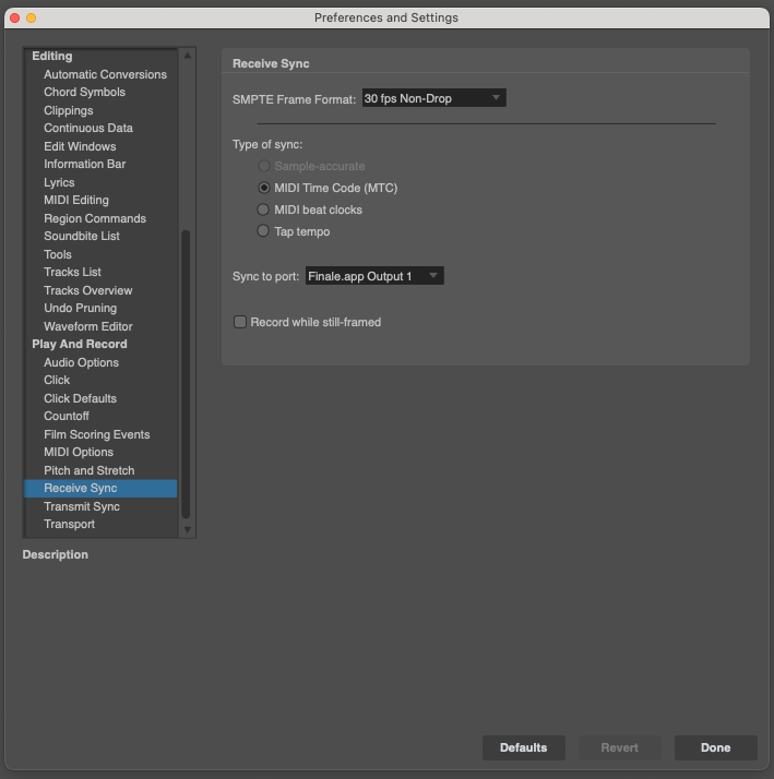

After a long time, I was able to have Finale as a master and DP as a slave.
Is my configuration correct ?
In DP Receive Sync : SMPTE Frame Format : 30fps Non-Drop
MIDI Time Code (MTC)
Sync to port : Finale.app Output 1
In Finale MIDI Setup : Enable Inter-Application Ports and Send MTC to all
I use Note Performer and it has 1 second delay.
How can have the same timing in DP and Finale ?
Thanks
Thanks

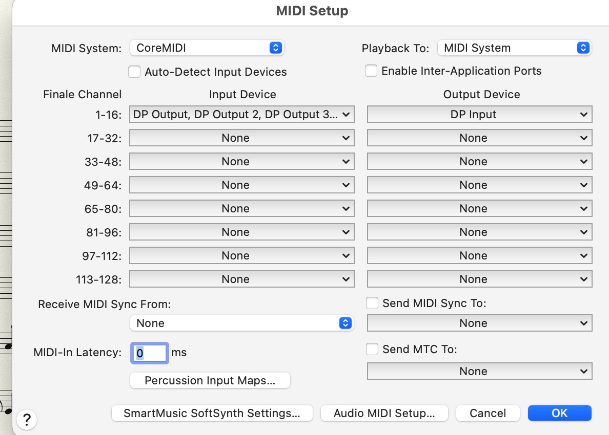

Re: Synchronisation
FMigulez, It works 95% ! Thanks !
I was able to setup IAC in DP and Finale.
Now the problem I have is this one.
When I start DP, Finale starts at the tempo of DP, that's good.
When I stop DP, Finale stops and that's good too.
But when I start again DP at measure 1, Finale goes at the beginning of the measure where I stopped.
For example I start DP at bar 1 and Finale starts. If I stop DP at bar 4, Finale stops but when I want
to start DP again at bar 1, Finale returns at the beginning of bar 4.
I need to go to the Playback Control and manually write bar 1 in Finale ......

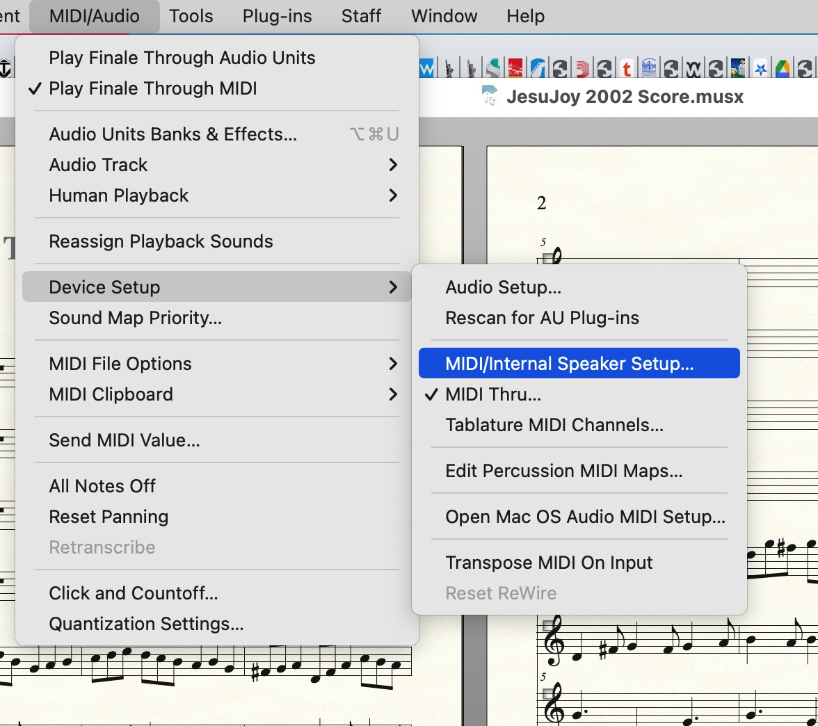

Re: Synchronisation
When using DP as a slave, I set it up from within Finale, normally to record MIDI since DP does not have MusicXML Import.
Ok, screenshots are working again…

As for that stubborn behaviour in Finale, I suppose it must be some kind of preference to uncheck, like the equivalent to DP's auto rewind, so it restarts at the same place as the master, DP.
I'm not sure where that setting would be; maybe in its transport hidden commands or in Finale's preferences..
I'm sure Mike knows. Hopefully he'll see this last setup detail issue you're having.
