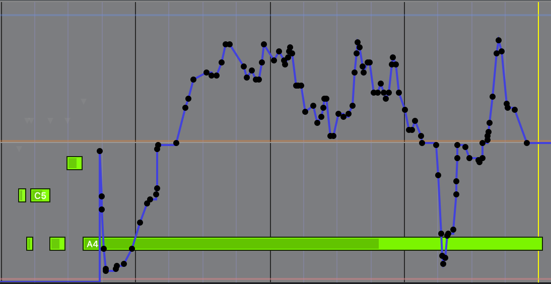

I messed around with Thin Continuous Data, and went from this:

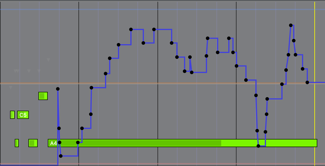

To this:
That approximates the effect, but finding the value to insert into the Maximum Value Change field is going to take some math or trial and error.recording: Mac Mini 2018 - 32GB RAM - 3.2 GHz 6-Core Intel Core i7 - two Focusrite Scarlett 18i20 - OS 14.7.2 - DP 11.34
