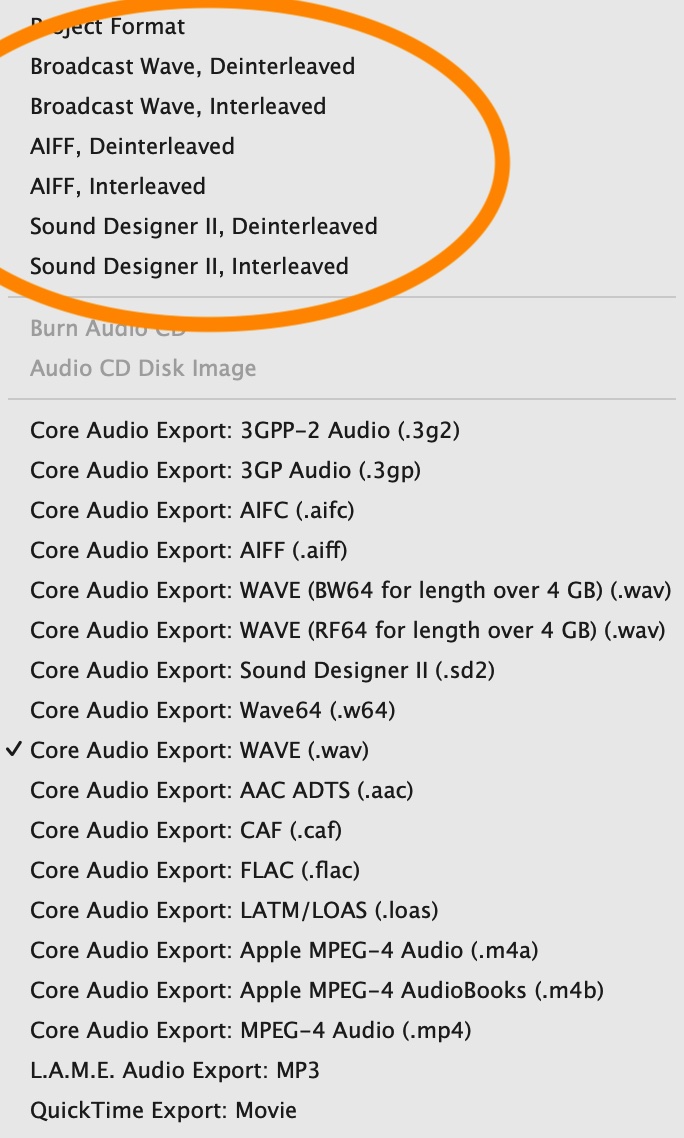

- Posts: 16191
Re: error when bouncing to disc
Yes, it affects both Intel and Silicon Macs.
Fortunately, exporting to the non-CoreAudio formats works fine.
