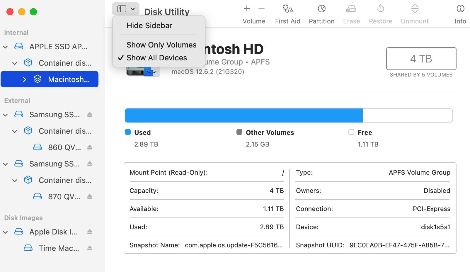

The drive cannot be formatted as it isn't seen by the desktop or by Disk Utility, and yet a system report shows it as connected, though bizarrely not to port 3 of my TB hub. Also, the light on the drive isn't lit.
I think this happened with the last SSD as well.
Maybe we have to plug it in directly to the computer the first time, or use OWC's drive formatter?
I've already restarted the computer to see if that was the issue.

I've seen this before. In DiskUtility, you need to Show All Devices and un-hide the Sidebar. As you've not formatted yet, there are no Volumes to show. Why this isn't the Default is a mystery to me.mhschmieder wrote: ↑Sat Dec 24, 2022 3:20 pm The drive cannot be formatted as it isn't seen by the desktop or by Disk Utility, and yet a system report shows it as connected, though bizarrely not to port 3 of my TB hub. Also, the light on the drive isn't lit.

Mike, thanks, I am pretty sure that is what happened when I bought the earlier Envoy Pro SSD from OWC. This time, I used their utility, but I unchecked the cyber attack protection software that it wanted to install.
Your visual does ring a bell though. I am almost certain I followed those steps with the previous SSD.
I think I'm good to go now. I'll try plugging it back into the dock now that it is formatted. I think the older model is directly connected mostly because it has a super-short tethered cable that probably was designed for laptop use.

It's OK on the TB hub now that it is APFS formatted and after a computer reboot.
Also, I am now plugging in the older model to the TB hub, with no issues.
