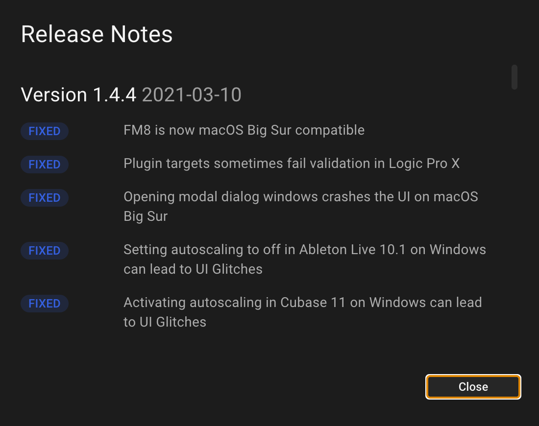

In this NI Community thread, someone from NI Customer Care says that FM8 is scheduled for updates.
https://community.native-instruments.co ... mment_4628
I forgot that I can look this up in Native Access (updated to 2.70 this morning):
Screen Shot 2022-10-12 at 5.45.03 PM.png (110.78 KiB) Viewed 4088 times

Per the NI links to the Customer Care post, FM8 is scheduled to become AS Native at some point (all of Komplete 14 will be). When that happens, running DP over Rosetta 2 will not be necessary unless you are using other non-Native plug-ins.
