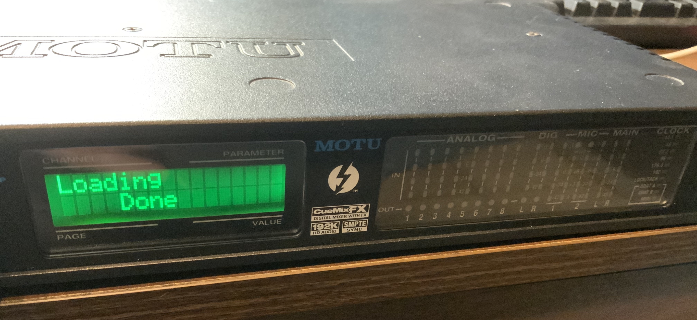

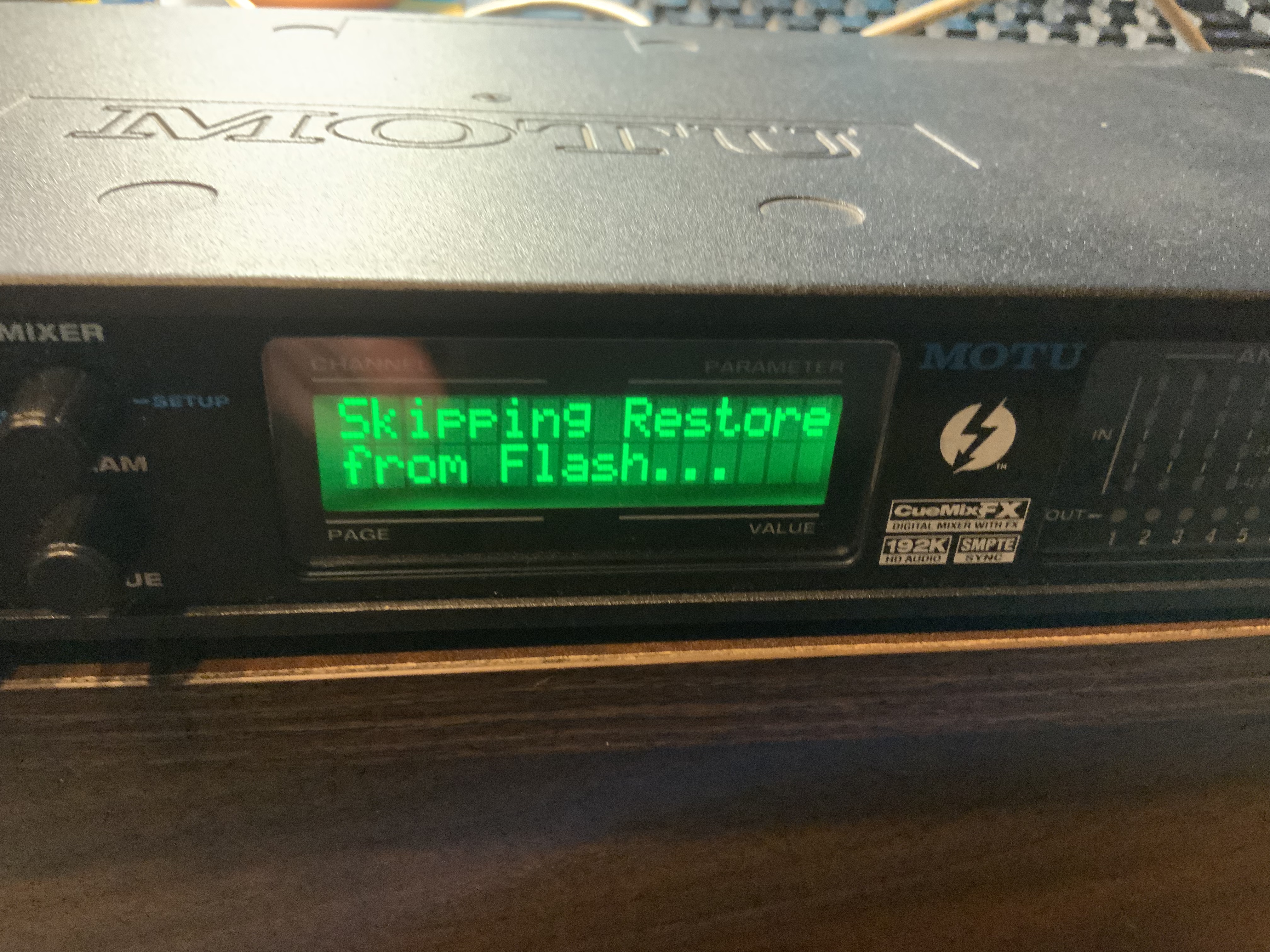

Hey everyone. Motu Nation newbie here. I’ve been trying to set up a 24 track studio comprising of 3 828xs that I acquired used from private sellers. Two were tested and seem to be working ok, but the third one, when I initially turned it on, first shows the Motu Firmware screen (Motu 828x 1.07), and then ‘Loading Audio Router…’, both bright, then ‘Loading Done!’…and then it just keeps circling in this loop. It never reaches the ‘Cue Mix FX’ load up screen. I’ve tried pressing the Param button to do a factory reset but it does nothing. I also tried pressing the Page button which occasionally gives me the ‘Skipping Restore From Flash’ message, and then nothing. If I press Page again, it goes to ‘828x Boot v.1.01’, which allows you to reinstall the 1.07 firmware if you like, though if you just turn the 828x off and on again it will restart with the 1.07 screen. Anyway, when I used 828x Updater.exe, it ‘reinstalled’ the firmware 1.07 that was already installed, and nothing changed upon ‘Power Cycle Down and Restart’. Still stuck.
I am afraid the seller sold me a lemon. When I went back to them and told them this, their response was ‘well it was tested and working well when we sold it,’ and they accused me of doing something to the unit. I should have known, their sell pics did not contain any shots of the unit turned on.
Does anyone have any insight into this? I’ve attached some reference pics for y’all. I only attached 3 because i think we have a limitation on how many can be attached.
By the way, I did speak with Motu Tech Support and they didn’t seem to have any advice, if I can’t access the LCD screen to do the factory reset. Additionally, they told me any updates or reinstall action of firmware would have to be done on a PC, which i did with our home PC. I actually plan to run the studio on my iMac running Mac OS 11.6.8 currently (Big Sur). Might there be some way to shock this unit to life by reinstalling firmware through the Mac download? Tech Support told me to do all the updates in Windows, unless I misunderstood.
Hoping for a Lifeline…thanks all in advance for reading through this long post. This is very distressing to have this happen right out of the gate with this unit…ugh

Re: 828X Stuck in ‘Loading Audio Router, Loading Done’ Loop
Thanks for the quick reply, Mike. I did try the following method for Factory Reset for 828X, by many methods, aka 1. Holding down the Param button before turning on the unit 2. Waiting until the unit starts until holding Param 3. Pressing Param multiple times rather than holding it down.
None worked. That’s why this is so distressing. I tried below but never got to an ‘828X Setup’ phase because it’s stuck in the Loading Audio Router, Loading Done loop and the only way I can get out of it is by pressing the Page button which then gives me either ‘Skipping Restore From Flash’ or ‘828X Boot V1.01’

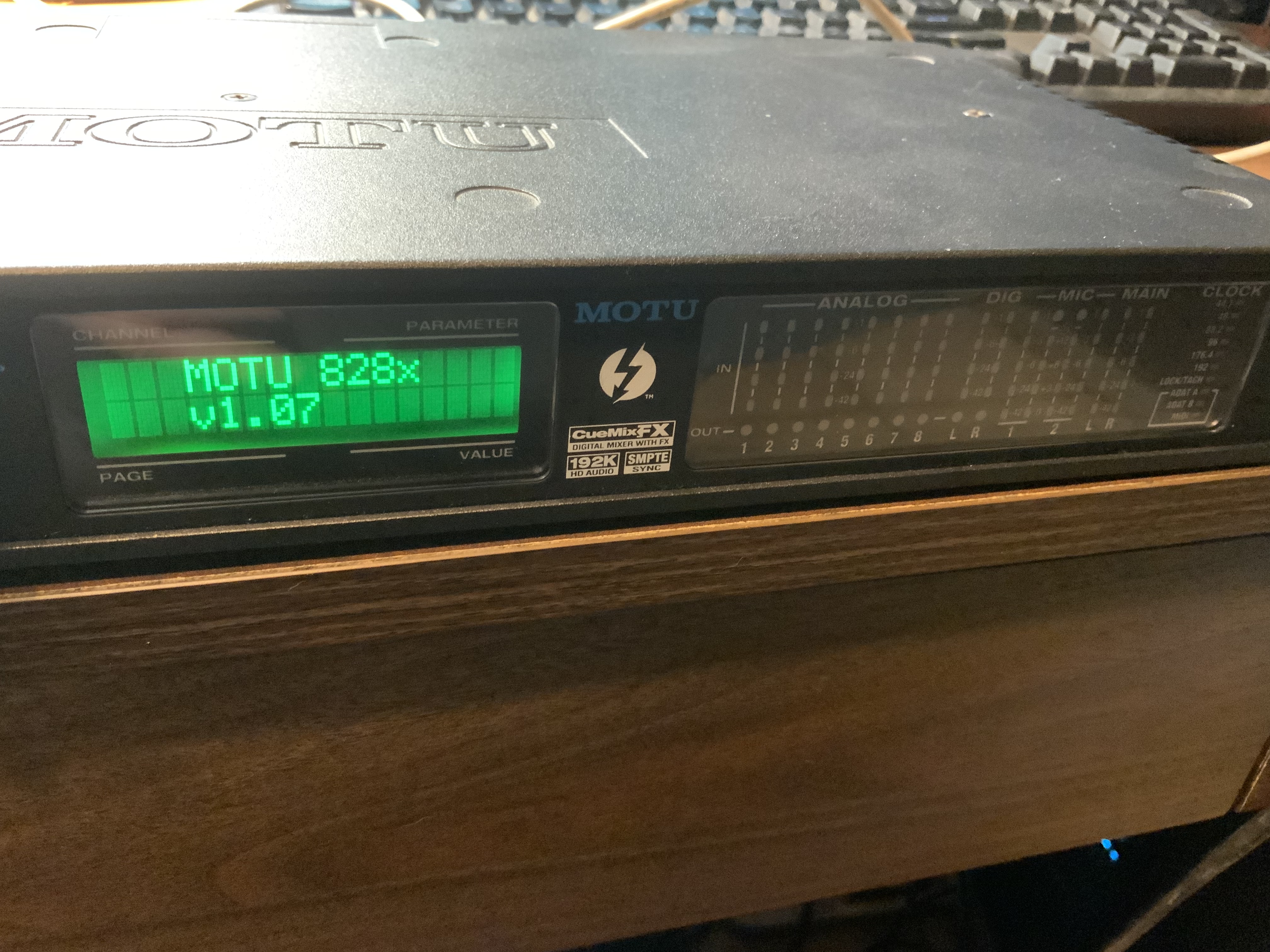

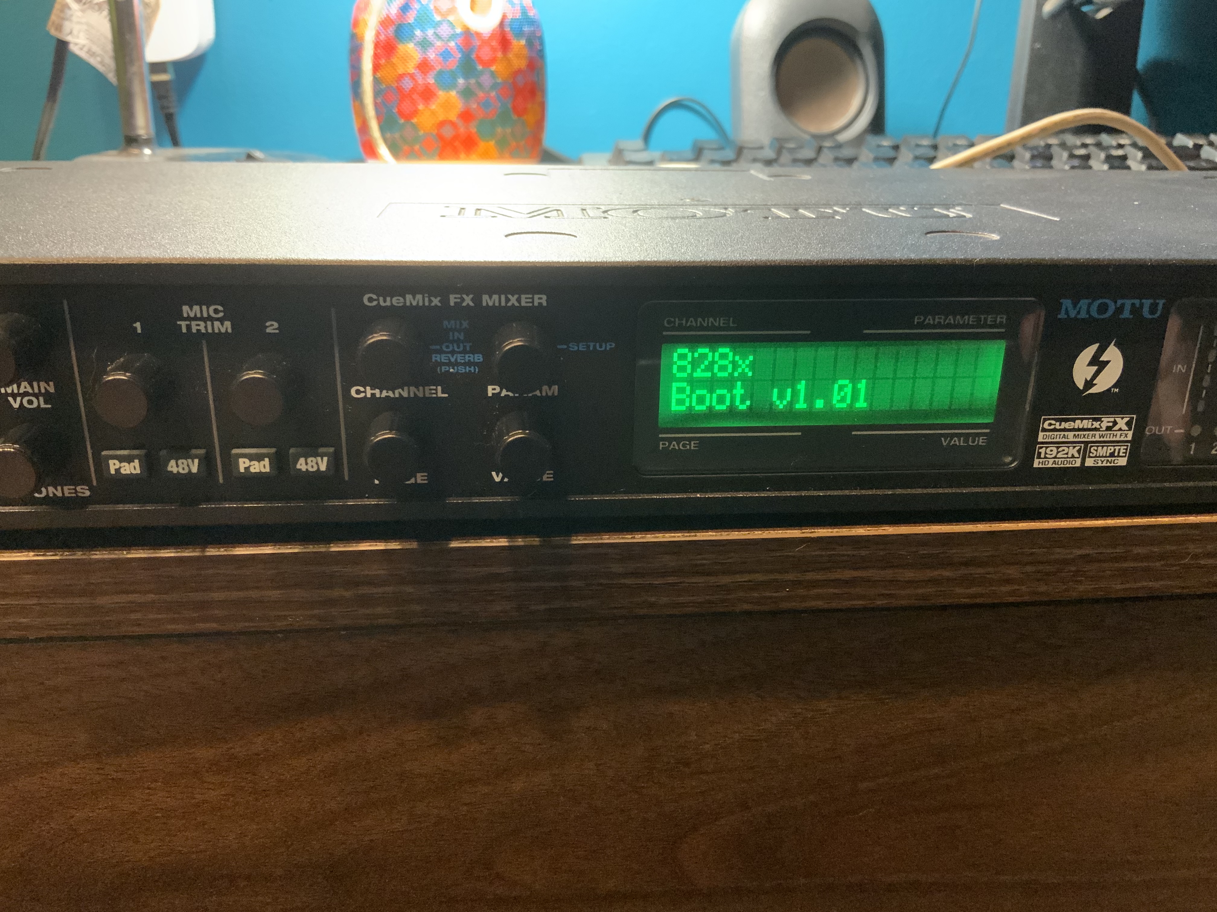

By the way, to the group, here are some images of the screen information displays I’ve seen when I’ve pressed the PAGE button after seeing the 828x v.107 screen, then seeing it go into the Loading Audio Router, Loading Done loop. As previously mentioned, the Boot V.1.01 mode just allows me to re-updat the firmware to the 1.07 that’s already there, and restarting the 828X after this does nothing. And I can’t seem to access any other menus but i thought the fact i could access these might point to some hope of a sequence that could get me outta this loop…

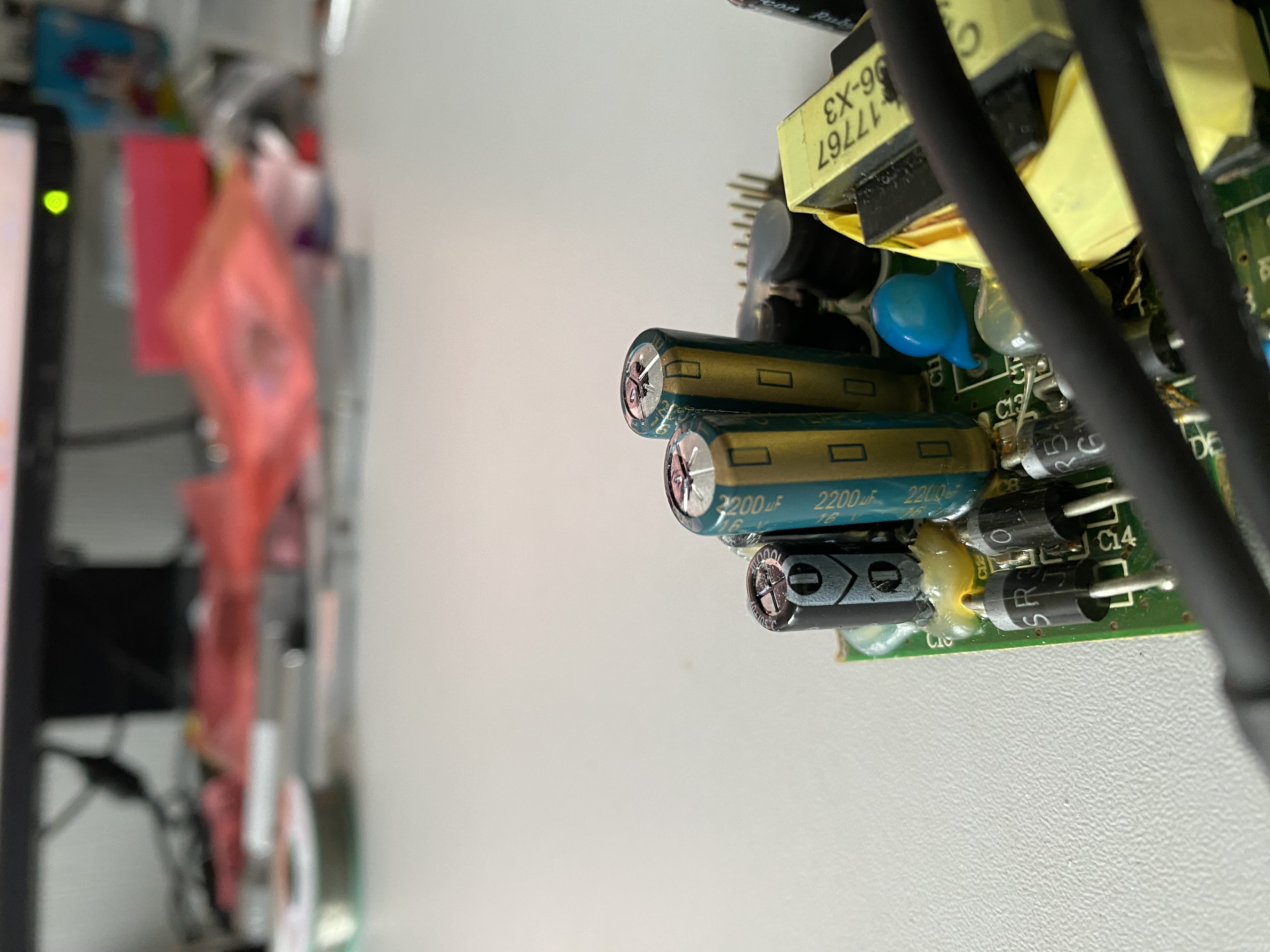

Hi All,
Exactly same problem with my 828 MK3 Hybrid, and problem is solved
When you open the 828 box, there is a secondary card with points to check voltages. I checked voltages and instead of 3.3v, it was around 2.4v, and instead of 5v, it was 4v. The PSU caps where not in good shape, so I change them, and... it works !
What I learned when trying to repare the card :
- The 2x2200uf caps are used for 5v line, and the 2x1000uf are used for 3.3v line.
- If the card dont start at all, there is a problem with 5v line.
- If the card start, but get stuck at loading or next step "CueMix FX...", then there is a problem with 3.3v line
I expect this can be usefull for somebody else.
Regards
PhilMus
