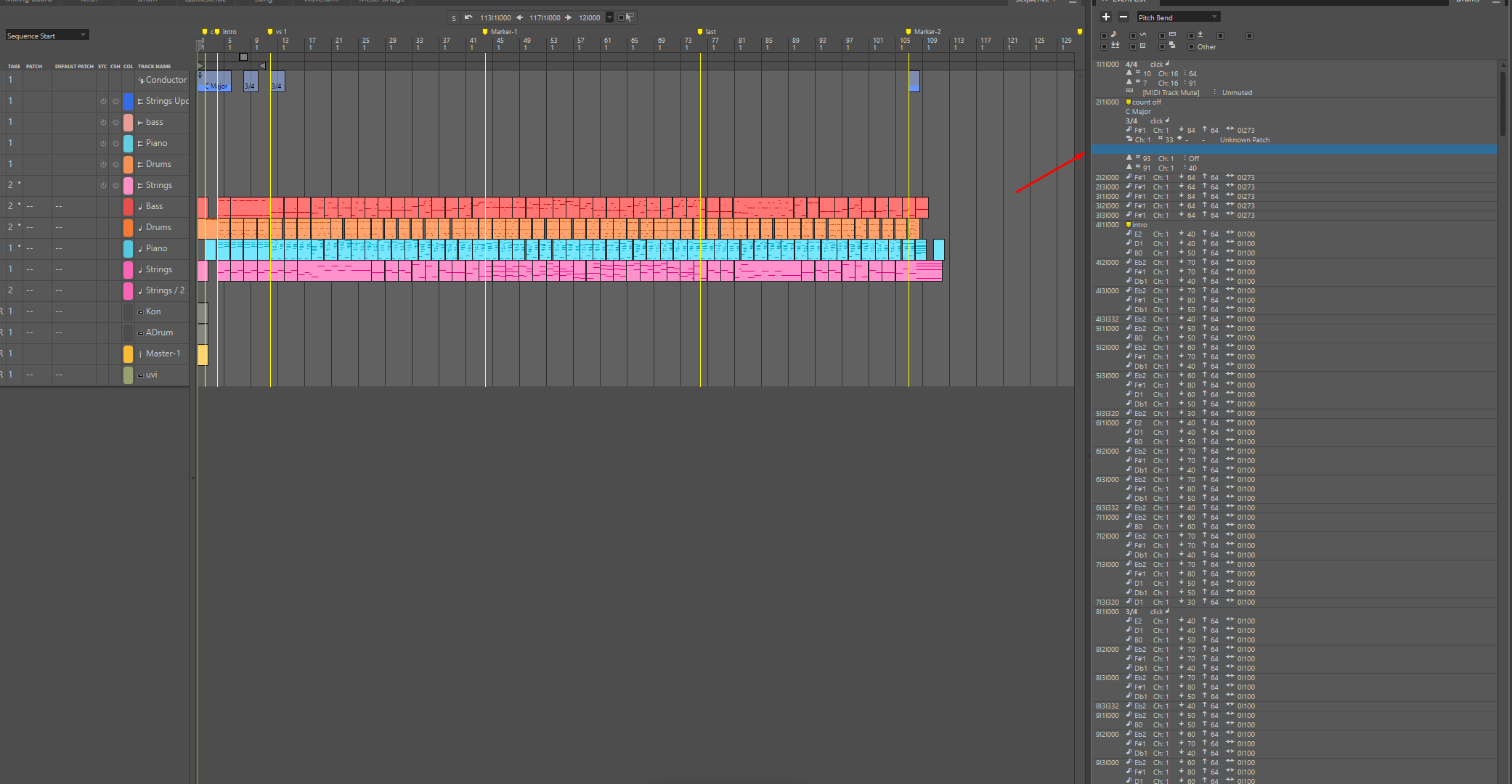

I got on the chat line with a MOTU tech this morning. Eliminating the data of one track at a time, testing after each, he narrowed down the possible cause. I ended up emailing one of the projects to him and he found (in the event list) an empty spot in a couple of MIDI tracks. That turned out to be the culprit in my case.
How did that happen? I started out with MIDI tracks from BIAB and I deleted some of their CC data.
- DP event list empty spot.png (221.56 KiB) Viewed 1235 times

So... the issue was, apparently, anomalous data.
Re: Sequence editor won't open (RESOLVED)
Yes Markus, an anomaly that was anonymous! I certainly learned a bit about logically breaking down problems like this.anomalous data

Glad that MOTU Support was able to help you sort that out. Although I'm a beta tester for BIAB and a few other apps, it never would have occurred to me to go there.How did that happen? I started out with MIDI tracks from BIAB and I deleted some of their CC data.
It turns out that BIAB exported the MIDI with the unassigned space. BIAB has caused problems with DP in the past but I don't recall seeing this happen.
