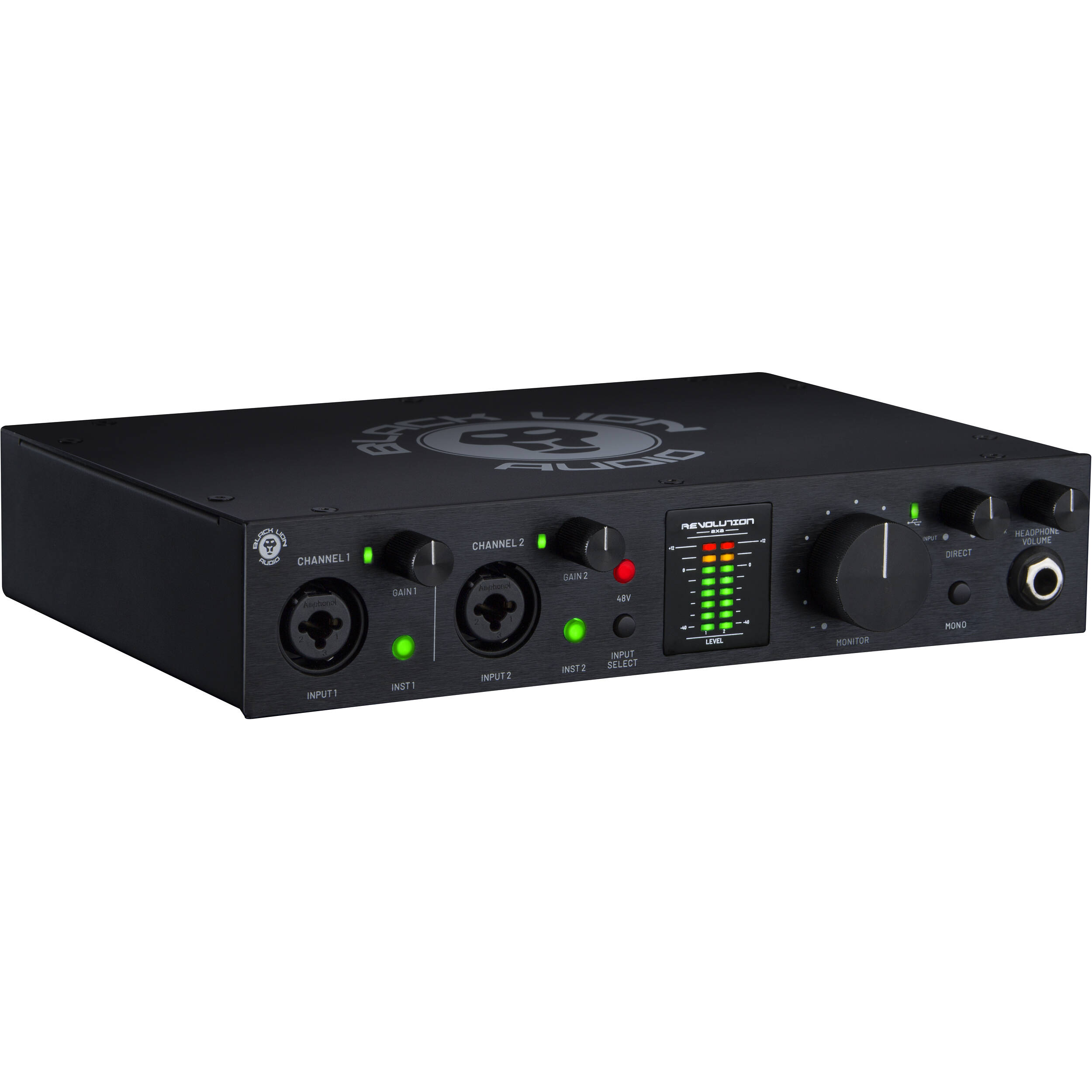

Thanks! I actually have the original Apogee Jam so that may in fact be the issue. But, then why would it work okay in Logic Pro and not DP?
I ordered a new interface anyways. Had been planning on it for awhile. It arrives this Tuesday or Wednesday. It’s a Black Lion Revolution 2x2 USB interface:
