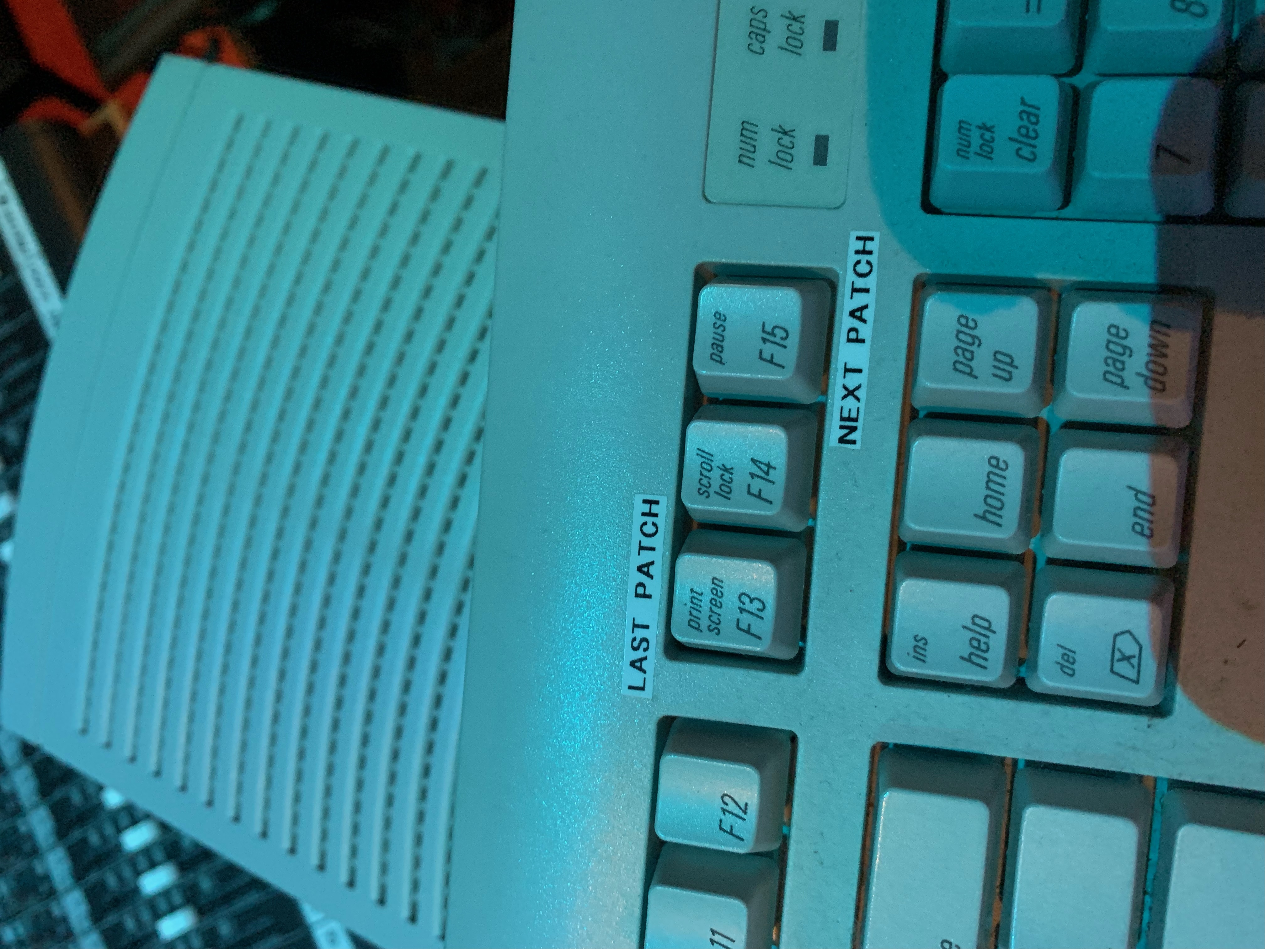

Thanks Jon! This helps a ton.,,,I found the Command and Next Patch Last Patch functions.
But I cannot get it to function. I have also tried assigning different keys to these functions and nothing.
I am sure I must be missing something obvious.
I looked at my old Mac G3 and I had set up the F13 and F15 keys and it worked great.
Frustrating....
Frustrating....

It might be basic, but make sure you don't need to hold down a modifier key to get it to actually send function keys. Looks like a Windows keyboard?
