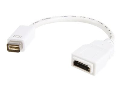

The big connector is Apple's version of DVI—not quite the same as DVI (ADVI carried the monitor power, too) but adapters exist. I remember my G5 having both ADVI and DVI connectors—my G4 may have them, too. The only ADVI monitors I've ever seen were branded Apple..
Without a good straight on look at the other connectors, they might be Mini DVI or MDP depending on the year.
https://en.wikipedia.org/wiki/Mini-DVI
Here's a picture of a Mini-DVI to HDMI adapter.
Notice that the connector is rectangular compared to the MDP port below. That's how you tell 'em apart.
There are 2 of them, however and that's a good thing. Yes, the right cables and/or adapters are all you should need.
