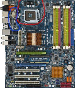

Still very much think it is a cap issue, but admittedly, the likelihood went down slightly based on that pic. Those are polymer caps, but even they can and do go bad...and the board is from 2009 as you've said.

On the upside, if it turns out to be surely a cap issue, replacements for those are extremely cheap and they're not very difficult to install. You can do it or if you don't own a soldering iron, you probably have a friend that does.
Just make sure polarity is correct when doing so.
The ones in the red circle are highest suspects to replace and the ones in the blue circle are a little less (but still so) suspect. It's due to the heat from the cpu and I bet you don't have an aftermarket high-performance cooler:

actually i have a Scythe Orochi 1000. getting that block out of the housing is a pain in the ass though... hope it is worth it.
