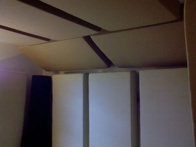

Acoustic treatment, seen from the doorway.

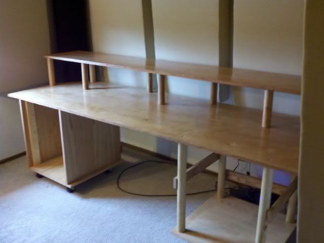

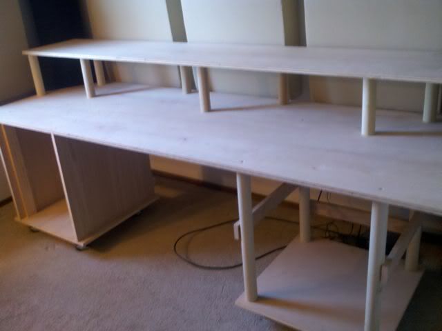

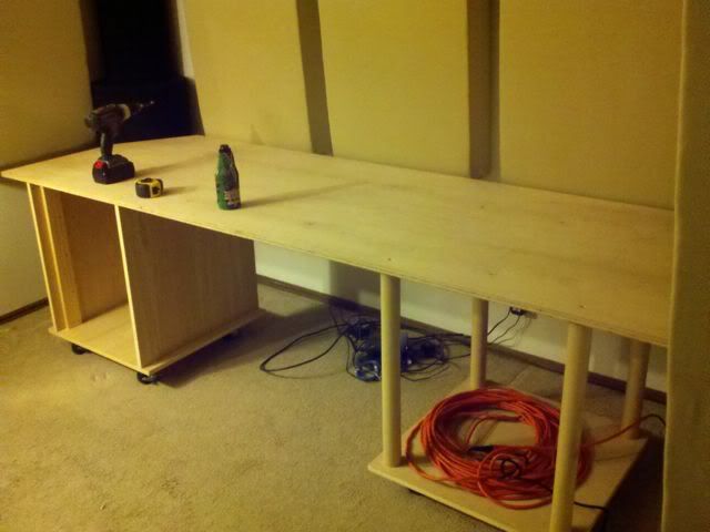

The desk ready for the monitor bridge.
Desk with bridge attached, ready for stain.
Stained and ready for gear.

Tell us more about those panels. Are they DIY or did you purchase them pre-built? I'm with Mr. Frodo on Home Depot, but let's not ignore the electrical and plumbing departments. Lots of goodies there too. I'm planning on making some gobo stands out of PVC pipe. PVC is your friend.

Acoustic panels were DIY. 1"x2" frames with fabric backing, heavier fabric, and 2 2'x4' panels of Auralex acoustic insulation. So each panel has 4" of acoustic insulation. There are also a couple of cylindrical bass traps in each corner. So far, I'm pleased with the results. Very anxious to actually mix in the space.
