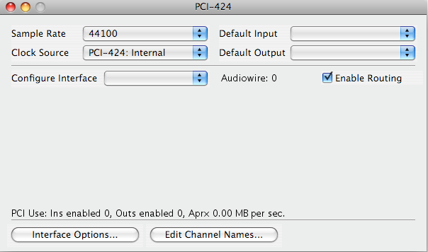

Anyway been using a Motu 2408 since 1998 with the occasional problem, mostly the mac not seeing the card but I haven't had any problems in a long time. Now after having to shut my mac down by holding the power button when it booted the 2408 lights carried on blinking on the front panel. I checked systems profiler and the Mac is seeing the card and driver installed as seen here -Image
but when I open Motu PCI Audio Setup all I see is this -
Don't know if the card or interface is shot. I have tried all the usual things, repaired permissions/zapped pram/applejack and also tried the card in all the available PCI slots and different Audio Wire and still no cigar!
Anybody seen or had a similar problem as this is starting to play with my head!

Quick update -
Still not working but things have got a little stranger, now the mac sees the card in the PCI slot, but doesn't see any driver installed.
Just un-installed the card, uninstalled the motu software, repaired permissions and rebooted. installed the motu drivers once again and shutdown. Then I installed the PCI card once again and still the same thing, the mac doesn't see a driver installed!?
if I try to launch Motu PCI Console I get an error message saying no PCI 424 installed !?
I'm totally lost now.

The card was indeed faulty, Music Track (Motu Distro in the UK) replaced the card for £70.
