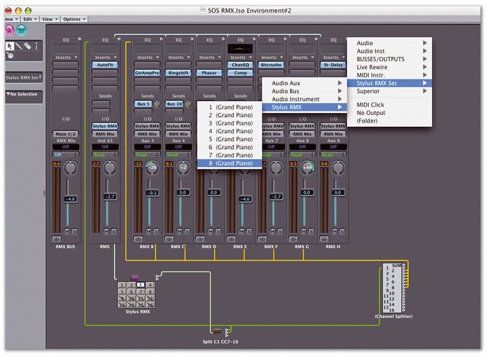

Here's why:
That's a Logic Window, btw.
====[/quote]
you don't have to do it this way thoguh. Because tracks are objects you can create multiple instrument tracks that reference the same VI in the arrange window using the command from the tracks menu. Each instance (track) gets it's MIDI channel set 1-8 (in the case of RMX) instead of all or omni.
Just throwing it out there. Of cource them you need to setup the biases and auxes, which while there is no bundles equivalent in logic anymore, isn't that hard to do.
I'd post a screenshot but I'm on my way to Hawaii.

I understand there are options, but in DP each track publishes MIDI channels 1-16 without setting anything up at all.buddhabelly wrote: you don't have to do it this way thoguh. Because tracks are objects you can create multiple instrument tracks that reference the same VI in the arrange window using the command from the tracks menu. Each instance (track) gets it's MIDI channel set 1-8 (in the case of RMX) instead of all or omni.
There are, of course, other things for which Logic's Environment are needed, such as the case which mickhol described earlier.
Sometimes, one would simply rather not look at stuff like this:
