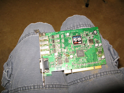

well you are right, that is the problem. i was fooled! I thought I had a PCIX card per this photo from the motu website.
Notice the slot tab configuration with 1 break. My card has 2 like the PCIX card.
I started looking closer and the date on it is 2002. So motu is missing an image on the website for compatibility.
Thanks for the help everyone, I'll just upgrade to the PCI-e[/img]
