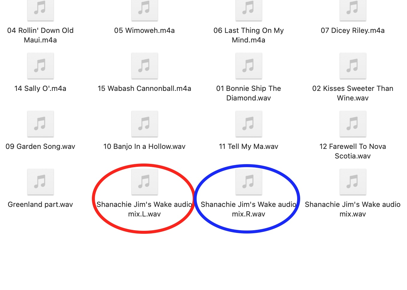

That doesn't make sense. Some of my collaborators send me de-interleaved files. Also, I created one in DP just to test this before answering. If I drag either of the circled files into a stereo track in DP, the result is stereo.FrankM wrote: ↑Tue Jun 10, 2025 12:11 pm Thanks but that didn't work. I created a stereo track and dragged one of the files to it, but it didn't give me the typical blue outline that denotes being able to drop the file or soundbite. Releasing the dragged file on the track resulted in no action. I tried both dragging the file from the Finder and the soundbite from the soundbite window. Both will only drop into a mono track. Sample rates definitely match. I gave up and used Audacity.
- De-interleaved files.jpg (149.65 KiB) Viewed 320 times
- Screenshot 2025-06-10 at 2.24.53 PM.jpg (370.29 KiB) Viewed 320 times

OK I'm back to take my medicine. The elevator finally got to the top floor.
When my friend sent his PT files, the keyboard track's two (L & R) files were saved with these names:
17-KEYS L-250405_2104.wav
18-KEYS R-250405_2104.wav
I then added the suffixes "L" and "R" like I thought DP wanted:
17-KEYS L-250405_2104.L.wav
18-KEYS R-250405_2104.R.wav
Sigh... well I'm sure it's apparent why I couldn't get them to convert to interleaved or drag into a stereo track. Except for the "L" and "R" I added, the filenames must be identical.
He recorded an "audience" track that was interleaved stereo, so it's obvious PT can do it. Why not the keys also, I don't know. Lesson learned and sorry to take up the bandwidth here.
