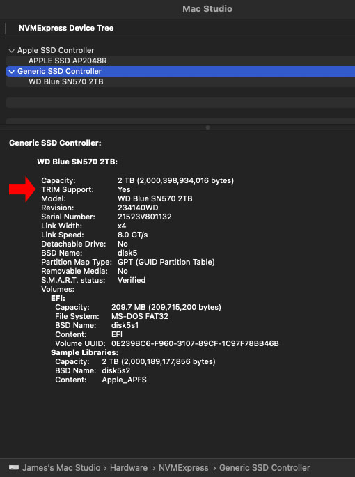

What about NVMe drives in USB4 enclosure? Do they even need trim? I guess since I’m using it for sample libraries it’s a “mostly read” situation.

TB4 is built on the USB 4 spec—possible that the only real difference is the fact that TB3/4 is licensed and certified by Intel. If connected via a TB3/4 cable, a blade in a USB 4 housing might support TRIM. I’ve not read one way or the other. I’ve been meaning to ask.James Steele wrote: ↑Sun Sep 10, 2023 8:25 pm What about NVMe drives in USB4 enclosure? Do they even need trim? I guess since I’m using it for sample libraries it’s a “mostly read” situation.
It will be easy to see in a System Report. TRIM Support will be Yes or No. There’s no way to enable or disable it. Garbage Collection is normally good enough but with TRIM, preparing cells for new data is a lot faster. I have recent experience wiping and rewriting nearly full 4TB SSDs.

Only way I could see a reference to Trim Support was by navigating the the NVMExpress section and it shows me the WD Blue NVMe drive in my USB4 enclosure. it says that Trim is supported (indicated by the red arrow). I'm not sure if it's already operating this way, or I still have to force it with the Terminal?mikehalloran wrote: ↑Sun Sep 10, 2023 8:42 pmTB4 is built on the USB 4 spec—possible that the only real difference is the fact that TB3/4 is licensed and certified by Intel. If connected via a TB3/4 cable, a blade in a USB 4 housing might support TRIM. I’ve not read one way or the other. I’ve been meaning to ask.James Steele wrote: ↑Sun Sep 10, 2023 8:25 pm What about NVMe drives in USB4 enclosure? Do they even need trim? I guess since I’m using it for sample libraries it’s a “mostly read” situation.
What's interesting is the 209MB EFI volume thats formatted FAT32. I guess that's a standard thing. I'm pretty sure I reformatted that drive when I bought it to APFS... and you can see the Sample Libraries volume underneath the EFI volume that is indeed APFS format.

Now we know. TRIM is unblocked by default over USB 4. There’s no command to block or unblock except for 2.5" SSDs that I know of. When TB5 is released next year, it will be based on the USB 4.2 spec — safe to assume it will be the same.James Steele wrote: ↑Sun Sep 10, 2023 9:42 pm
Only way I could see a reference to Trim Support was by navigating the the NVMExpress section. I'm not sure if it's already operating this way, or I still have to force it with the Terminal?
It’s quite possible that the FAT32 volume is the culprit—GC only works in it?—but that’s a guess. Without knowing the drive firmware, that’s as good as I can do. Since unblocking TRIM solves the problem, I’d declare victory. Otherwise, there may be a firmware update for the drive that would address this.

Yeah... the screenshot was from my Mac Studio in my studio. That's where I have the NVMe drive in the USB4 external case.
The problem I was having was with my MacPro in my office. I installed a 2.5" SSD into it had been the projects drive in a different MacPro that I used to use in my studio. It was solved when I force enabled trim on that drive.
