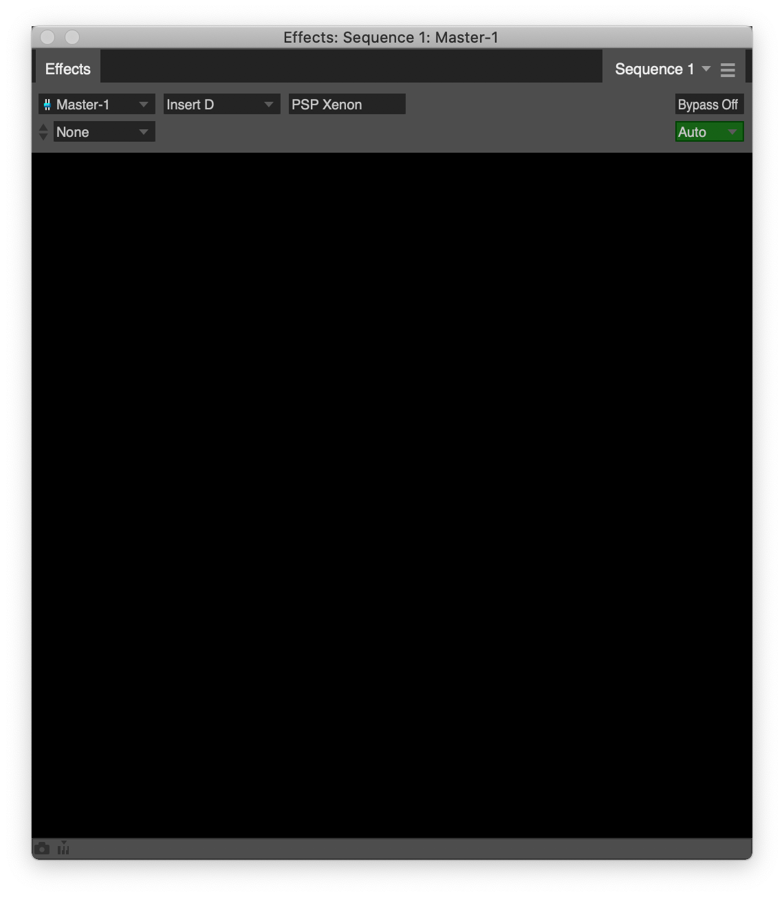

Has anyone tried installing the latest version of PSP 608 MultiDelay (1.8.0)?
I installed the Intel version (AU only) and it failed DP's examination process.
It seems to work, but I thought I noticed a few weird glitches a few times. A couple of times when I had PSP Xenon opened next to it, the GUI was all black (Xenon was black, 608 looked normal.) If I deleted the 608, Xenon would work properly again.
Tried it a few times today, and it seems to works normally. Even Xenon is working properly next to it.
Just wondering if anyone has installed this and if it passes the examination process for you or not.
I've been emailing back and forth with PSP, but it would be helpful to know whether or not I'm alone on this one.
I'm still on Intel and DP 10.13. Mac OS 10.15.7.
Thank you.
Thank you.

Thanks for that. I gave it a try but everything remains as it was. I just got the black Xenon screen again.mikehalloran wrote: ↑Sun Mar 12, 2023 3:13 pm Just for kicks, try a Safe Boot. If there are any corrupted System paths, this will repair them.
