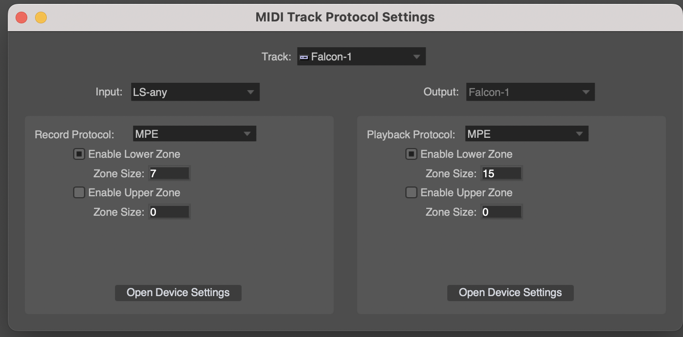

Can someone with an MPE Controller confirm the problem?
I'm using a Linnstrument

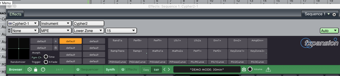

This thread got me wondering. I don't have an expensive ROLI, so I invested $3 in
https://apps.apple.com/us/app/ribbons-t ... d898059305.
I used it on FXpansion Cypher2 on a combined Instrument/MIDI track on the Cypher2 5D instruments and recorded. It played back exactly as I recorded it. Snoize MIDI Monitor showed MIDI data on all 16 channels. Note I am on 11.11. What am I missing?

I can't help you now. The app is polyphonic. The Event list doesn't show separate channels. Do you have the MIDI protocol set to MPE?:fdco wrote: ↑Sat Jun 18, 2022 11:36 pmHum, interesting,cuttime wrote: ↑Fri Jun 17, 2022 2:06 pm This thread got me wondering. I don't have an expensive ROLI, so I invested $3 in

Yes, the MIDI Protocol is set to MPE.
Also, the interest of MPE is that each note is played on a different MIDI Channel to allow Polyphonic Pitch bends (that is pitch bend per note), Channel pressure, and CC74 (per note).
So if you don't see separate channels per note, you're in the same situation as me.
Can you record and playback Polyphonic Pitch Bends, that is, one note pitches up and a second note pitches down simultaneously?
To rephrase my problem: When the transport bar is stopped, I can play my controller and MPE works fine.
BUT, when I play back what was recorded all MPE data is gone and, looking at the event list and MIDI editor, I see that no MPE data has been recorded.
