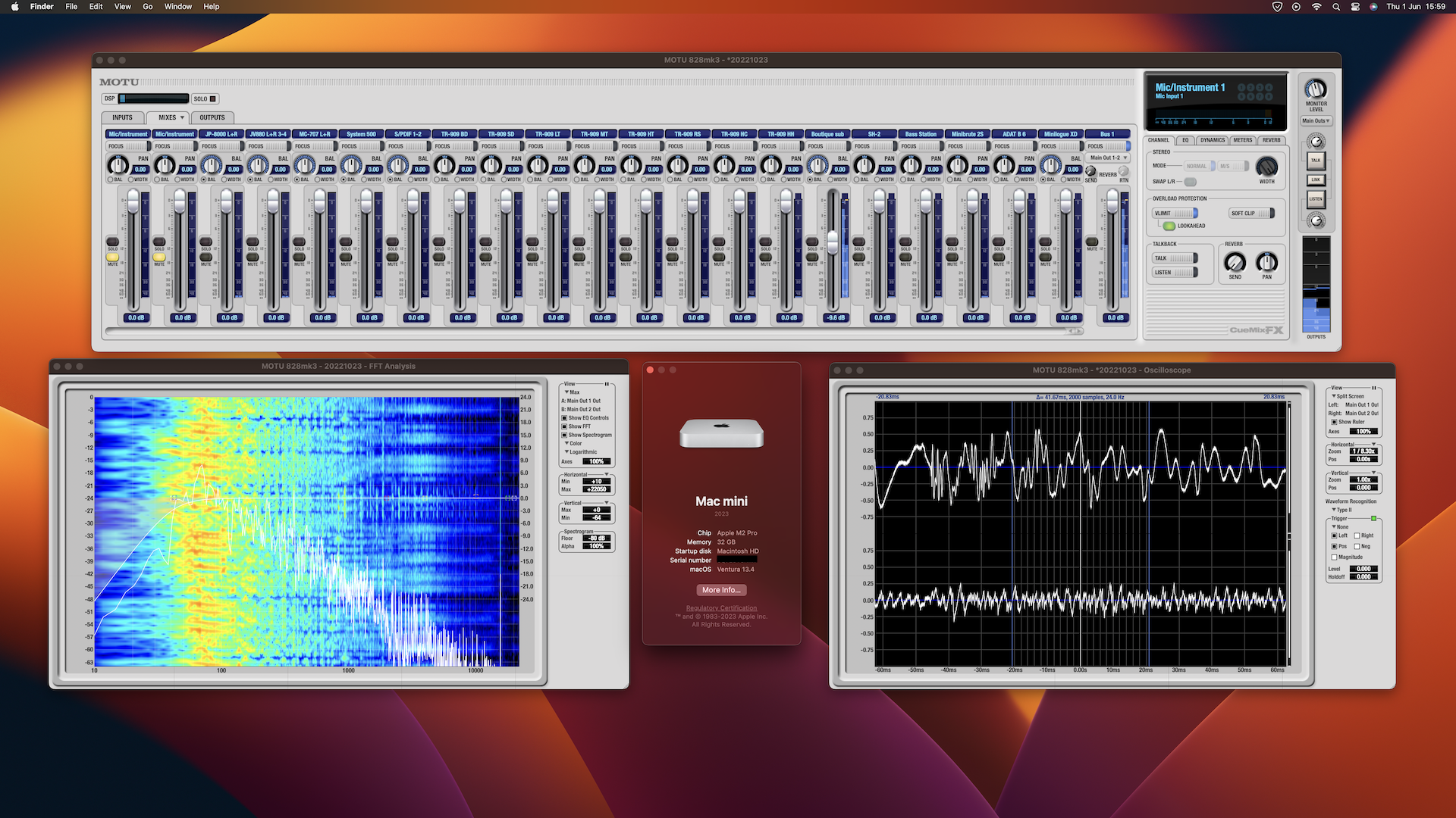

Just registered an account here to say thanks to everyone and especially @mikehalloran, and to confirm this still works fine on the latest macOS Ventura (13.4).
Got a Mac mini M2 Pro recently and thought now I really had to say goodbye to my trusty old 828mk3 Firewire. I simply followed the instructions and installed the drivers (I already had the two adapters) and it’s working fine!!
Running on macOS Ventura 13.4 as I speak. CueMix FX app works fine as well! Good times. So happy with this. Feels like my trusty old 828 got a new lease on life. :D
