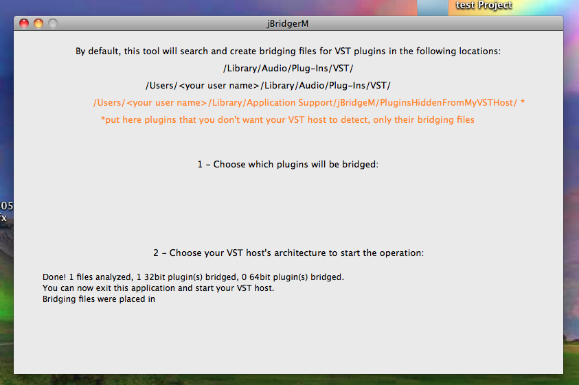

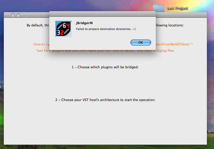

Despite 3 emails with Joao, I can't seem to get jBridge to work for me. It's too bad, as I too see the Memory Usage bar hit 80% when I revert to 32 bit mode in order to run my NI Pro-53, IK Sampletron, Young Compressor, and other favored plug-ins and VI's.
I've made VST my Primary Format in DP Prefs, run the jBridge App, moved the created bridge files into the root Library from my User Library, because that's where all my plug-ins are. . .
Has anyone had trouble with this, and then figured out what they were doing wrong, leading to successful 32-64bit bridging? I could use a useful hint
I often get the message : bridging files couldn't be created because proper location couldn't be found. I then go and find the bridging files which actually *were* created, at the Root Level, and move them into my VST folder as I mentioned above, but jBridged files still don't show up in DP's Prefs/Audio-Plug-ins List.
Thanks.

Much thanks, RG, I will try again, encouraged by your comments and success at it. Maybe it's because ages ago I renamed my Home folder to Homey
I thought I was being cool. Perhaps jBridge wants it to be the same as my user name, and that's why I get "can't create folder in desired location" type of alerts from jBridge. I won't move the created files anywhere. I'll keep AU as my preferred plug-in format, and I'll try to rescan, although I don't know how to re-scan plug-ins that do not even appear in that Preferences/Audio plug-ins Window...

Joao was very willing to help, but after maybe 5 or 6 emails, we ran out of ideas. For some reason DP 8 on my OSX 10.6.8 system will not see the bridged plug-ins. I am looking for them when DP is launched, and I open Preferences/ Audio Plug-Ins. If their names do not appear on the list (under 64-bit operation) then there seems no way for me to check their boxes, let alone rescan them. ("Reexamine" I believe DP calls it there.) In the Finder, they are all there, in the 'bridged plug-ins' folder inside my root/lib/audio/plug-ins/vst folder. You can see them. I've repaired permissions. I've (at Joao's suggestion, which I'd already tried anyway) moved them from my User/Audio/etc... folder to the Root/Audio/etc... folder. Trashed everything (including the files in Application Support) and reran jBridger. Tried making an alias. . . and undid everything before I tried the next thing.
I can see that others here are successful in using jBridge to run their 32-bit only plug-ins in DP in 64-bit mode.
but for the life'a'me, i can't arrive at where I'm messing up the process. I have VST chosen as the main format, even though RadioGal says that's not necessary, btw. Oh, also, I downloaded the demo of bidule, and running that in standalone, the bridged plug-ins are accessible. I also used Onyx to delete the AU cache, but since it's VST's not AU's that this is about, that was probably a waste of time.
Just once, I saw a glimmer of hope. I went back to 32 bit mode, and in launching itself, DP scanned a whole bunch of VST instruments and plug-in efx that it obviously hadn't scanned before. A similar thing may have happened when Logic/Mainstage became able to use 32-bit Audio Unit Bridge - I had given up and gone back to 32-bit mode; then one time I decided to give 64-bit a try again, and voila! the 32-bit plugs automatically called up that fabulous app.
