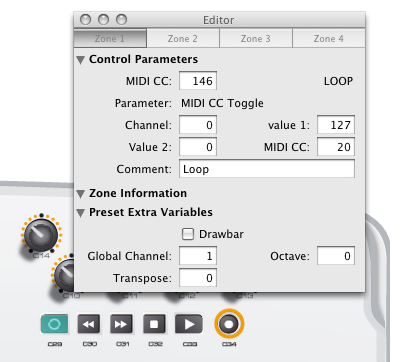

Then choose the preset on the Axiom/Oxygen you wish to set up. In Enigma you'll see a picture of your keyboard. Start by clicking on the first button in the series of transport controls... the "Loop" button. In addition to the main Enigma window you will see an Editor Window. When you click on the "Loop" button change the values in the boxes so it looks like this:
I've put the comment "Loop" in the Comment field.

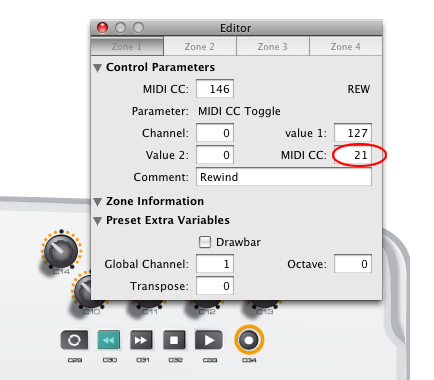

Now you're done with the Loop button. Click on the next button over, "Rewind," and change the values so it matches the figure like below:
Note that the MIDI CC value at the very top is always "146" to denote a MIDI CC Toggle. The only value that changes for each of the transport buttons is the MIDI CC value circled in red.
Now... repeat the process for the remaining transport buttons, entering the same values EXCEPT for the MIDI CC value which should be set as follows:

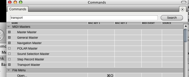

Now switch to DP and open the Commands window using Shift + L. Under the category "MIDI Masters" verify that "Transport Master" is enabled. If not select it. It should look like this:

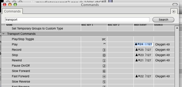

Once you've done that scoll down (or search on "transport") until you find the "Transport Commands" category. Find the row for "Play" and click in the MIDI Event Column. It should look something like this below. (Note I've already set my controls up... the boxes in this column may be blank when you do this the first time).
NOW PAY ATTENTION - This next little detail is CRITICAL!!
While the box is highlighted... press and HOLD DOWN the Play button on your Axiom/Oxygen transport. You should see the controller #24 and Value 127 as shown. DO NOT RELEASE THE BUTTON YET.
WHILE HOLDING DOWN THE BUTTON, use your computer mouse to click outside of this square... the title bar of the Commands window works for this. It should now accept Controller 24, Value 127. (If you had released the button before clicking outside the value box, the value would have changed to 0, which would not work correctly.)
Repeat this for the rest of the applicable transport controls working your way down through Record, Stop, Rewind, and Fast Foward. Just click the appropriate box, hold down the correct transport button on your Axiom/Oxygen, then WHILE HOLDING THE BUTTON DOWN, click on the title bar of the Commands window.

Top of the commands window, you have to engage the MASTER MASTER as well as the TRANSPORT MASTER button. Otherwise, (at least with my Edirol controller) you're dead in the H2O.
