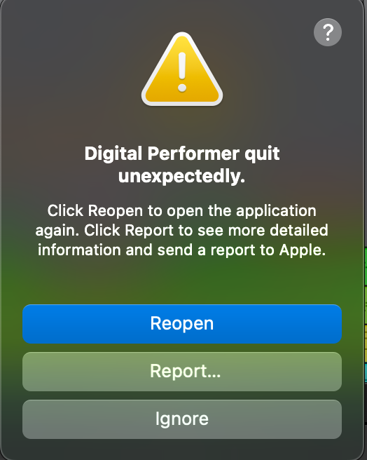

I was just about to upload this new bogus message I've been getting recently when opening or switching between Chunks. The bright side of this is that DP is NOT crashing at this particular time. I choose "Ignore," and go about my business. So, file this under Annoyances.
But, DP 11 continues to crash on open fairly often, and about half the time on Quit. It's less trouble to Save, then Force Quit.
Another issue is not seeing activity in my channel strip levels. Quit and relaunch fixes it.
