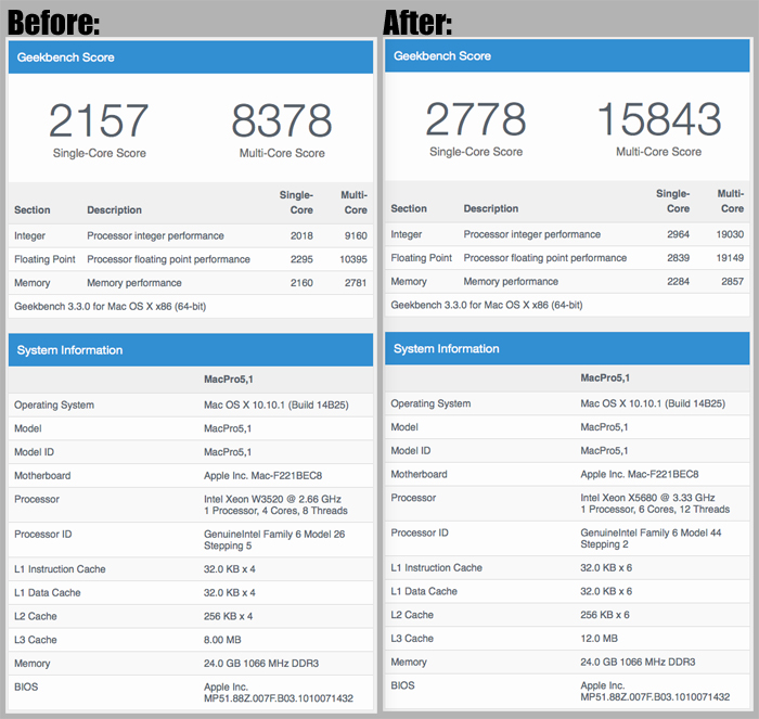

Just completed the swap. One of the easiest things ever. Pull out the Mac processor tray, remove the heat sink, release the retaining clip on the old chip, swap in the new one, close the retaining clip, clean the old thermal paste off the heat sink contact, spread new thermal paste on the top of the processor, put the heat sink back on, tighten it down, pop the tray back into the Mac and I'm done.
Below are the before and after comparison using Geekbench. Note that I had already ran the firmware updater prior to swapping the processor so in the "Before" test the Model is also shown as MacPro5,1, even though it's the original Quad processor.
I haven't loaded a DP project, but that's my next stop!

^^^ Nice James! Almost twice as fast!
You can use 1333 RAM now if you want, though with 24GB of 1066 unless you really need the speed it's kinda not a big deal.
