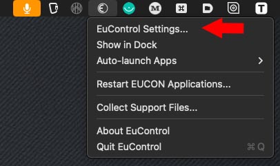

If you have properly installed EuControl on your Mac, you should see a little "E" icon on your mac's menu bar.donreynolds wrote: ↑Sun Feb 02, 2025 7:13 pm“If not, click the little “E” icon in the Mac’s menu bar and choose EuControl Setup (or something similar).”
I can’t locate this!
“Just remembered too… this is fairly new… in the EuControl Settings there’s a tab that says “Applications?” Choose that and then add DP to the list. I think you may need to find DP in the Finder and drag it into that window.”
Eucon control settings?
On the ipad?
I don’t see this option
You should click it and then a menu should open up like this and choose EuControl Settings:
Then choose the "Applications" tab and add Digital Performer to the list. I think you may have to drag the Digital Performer app in the Finder to that list in order to add it.

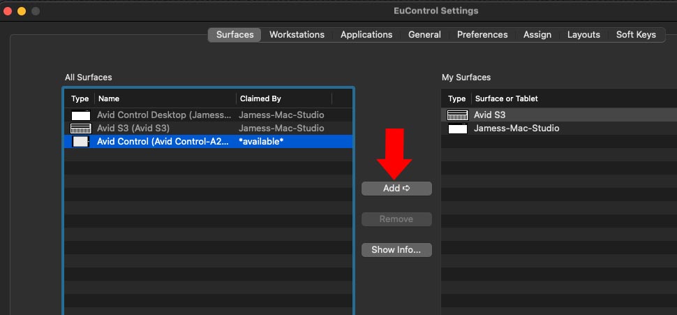

Oh... also forgot. Assuming you installed EuControl correctly and you found the "E" menu bar item... you may also need to add AvidControl as a control surface in EuControl Setup... may need to do that before you add the control surface in Digital Performer, but not necessarily.
So... have Avid Control running on your iPad connected to same WiFi network as your Mac.
Click the the "E" icon in the menu bar again... like described previously.
Then choose the "Surfaces" tab along the top. Below is a screen capture from my system. Ignore the other items in the left box... that just applies to my system. But see how I've selected "Avid Control... *available*"? Do that and then click the "Add" button indicated by the red arrow and it should then appear in the right box and you should see Avid Control on your iPad activate.
I'm sorry these steps are out of order here. Once you do that, you should be good. I'm going out of town tomorrow and I just don't have time to right a proper coherent step-by-step tutorial for getting this up and running right now.
