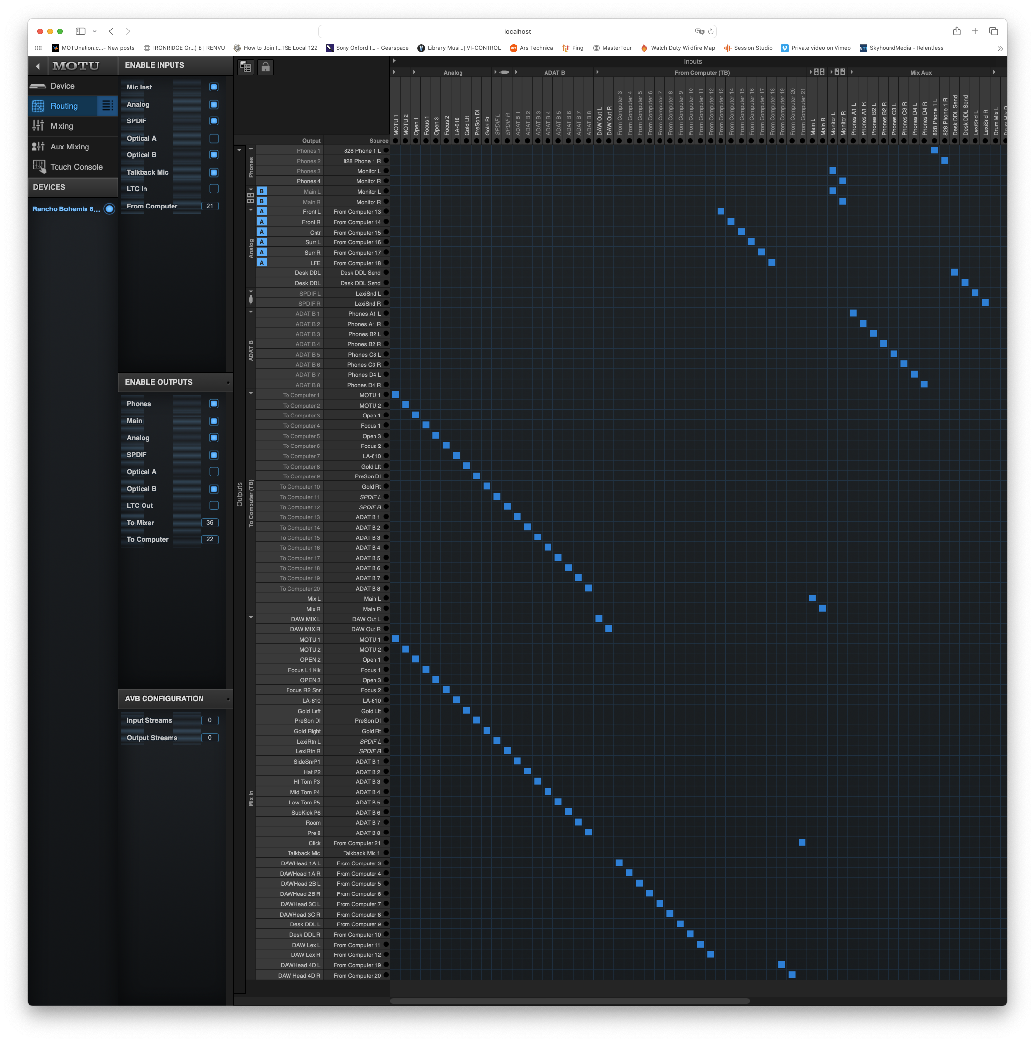

Sorry to have taken so long to get back to this.HCMarkus wrote: ↑Sun Feb 11, 2024 8:55 am When I play back stuff from the web, it routes right into DP. I can record directly in DP without an analog connection by simply recording from the main stereo output.
It has been years since I set this up; I'd have to review the 828ES matrix and my DP setup to recall how. Just know: it can be done.
If anyone really needs this, let me know and I'll review when I have a chance.
Below is a screenshot of my 828ES AVB Routing Page. Routing Main L and R back to Computer Mix L and Mix R (which are really To Computer 21 and 22) allows recording of any audio the Mac is playing. In DP Bundles, Mix L and R are routed to a stereo Input labeled "Mix" which I can select as input source to a stereo audio track and thus record whatever my Mac is playing at any given time.

I'm not understanding it. What exactly is Main L and R and how does system audio get there.

Good question. Its been so long since I set it up, I had to study it for a bit...
Since I have the 828ES selected for Output in Mac's system audio settings, system audio routes out thru From Computer 1 and 2 (horizontal top row, labeled "DAW Out L" and "DAW Out R") to the Main Mix, which is selected as Monitor source in the AVB Mixer.
In the top horizontal row ("Inputs"), "Main L and R" is the Main AVB Mixer Mix Bus sum (Input from the AVB Mixer, which I think of as a Source.)
"Main L" and "Main R" sources "To Computer 21 and 22" which I re-labeled "Mix L" and "Mix R" (Output column).
Hope that helps. I spent considerable time learning then setting up my AVB Matrix. It has been working nicely for me for years now, and I have thus managed to forget most of what I did.
PS: I should add that System Alerts and other such sounds are NOT routed to the 828ES, so any alerts that might be triggered while recording system audio are omitted from the recording.
