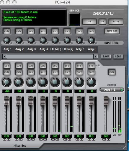

Ok i am the owner of a new PCIX 424 Card, not even a week old. It is talking to a MOTU 2408mk2.
I am getting noise in analog 5/6 bank A according to this picture in cue mix.
PS nothing is at all running on this chan 5-6.

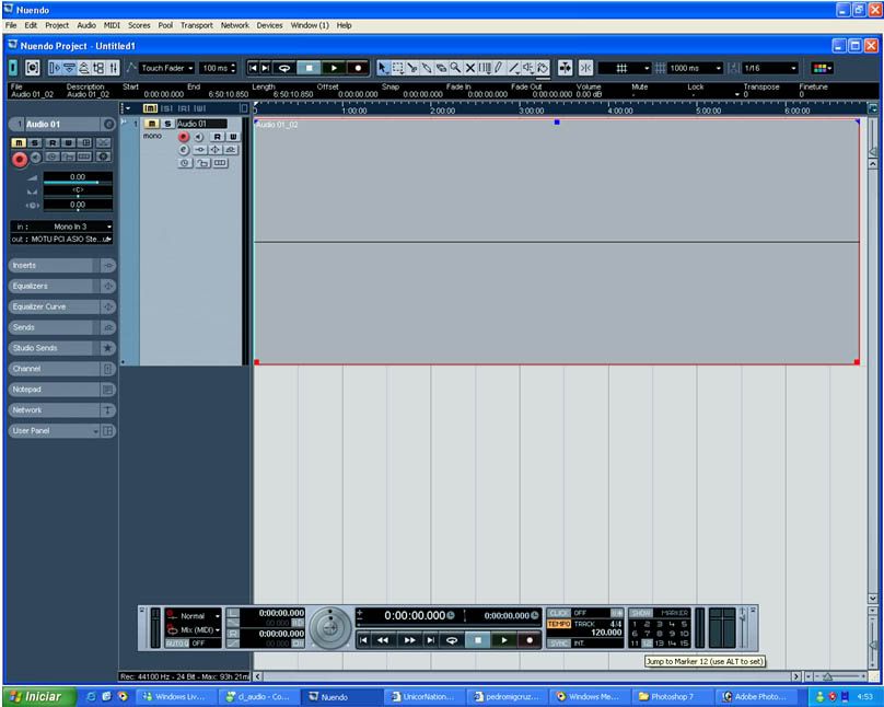

I tryed slot #3. I left windows media players playing mp3 repeating and random, i routed the analog out 3 to Analog in3 with a jack cable, i opened a mono track in nuendo recording the in3. so if i had any click it would be recorded by Nuendo.
I left it recording for 4hours, when i arrived it looked like a Kick drum track...
so far audiowire #1 #2 and #3 its out of the equation...
but there where times in audio file that i didnt had clicks i would say for 15minutes...
ill try this method in audiowire 4 this evening...

Ive just disable Hyper Threading and I let nuendo recording my out3 as i did before in other experiments and i didnt had any click at all in a period of 6HOURS!!!
Ive always had HT disable since i bought this computer, cause at the time neither Steinberg products neither PCI 424 drivers supported HT yet, and i cant remember since when i have the HT enabled, but i remember i enabled HT to see if it worth once in theory Nuendo 3 and the new MOTU drivers support HT, and even steinberg recommends HT...
so i enabled it to see if there were any improvements, and at the time i might not have clicks and left it enable...
Its not confirmed that this is the problem, but and really had improvements...
I guess that HT might cause clock problems once your CPU is divided in 2... i dont know... i know it got better
