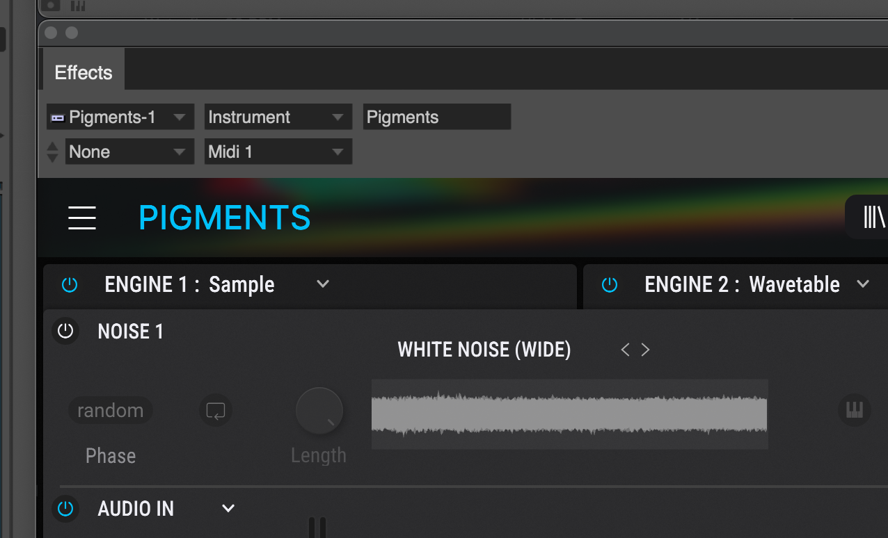

Thanks cuttime. That's where I thought it might be. The side chain dropdown shows up in many other plugs, but not Pigments for me.
Screenshot 2025-06-06 at 12.11.23 PM.png (603.31 KiB) Viewed 183 times
Odd.

Are you using the AU version? That pulldown is not visible for me there, either. Try using the VST3 version.

Bingo!
