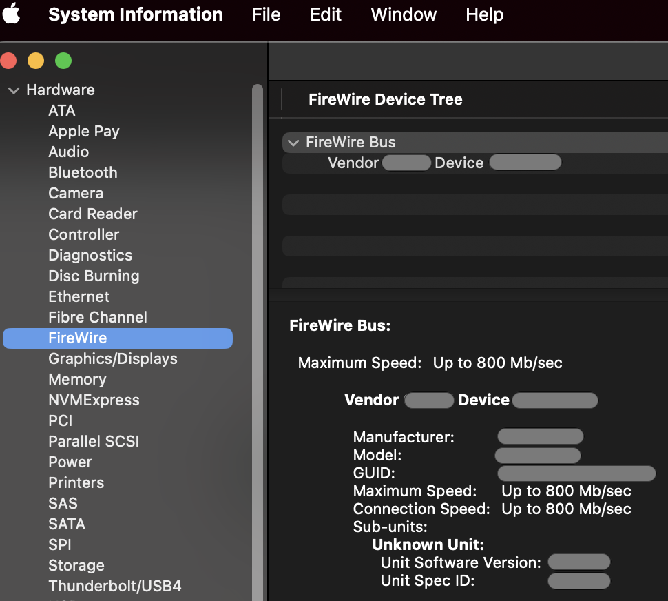

It might be useful to clarify if something has changed about Apple's "approach" to firewire. I.e., will it absolutely not work, or does it's tolerance of firewire connection continue to be 'vestigial"? IIRC, Apple has long stated that it no longer supports FW, while FW continues limping along (my woes not withstanding). Apple does occasionally pop-up veiled threats: "There is a system extension that will stop working in a future OS update." (or words to that effect) then it shows the driver for my FF800.

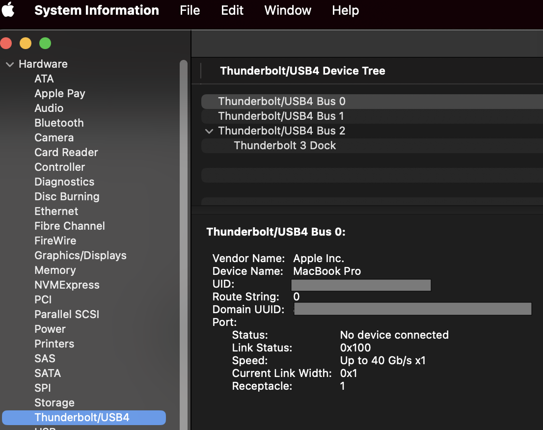

I have a specific model of OWC Thunderbolt 3 Dock that has a firewire port (I believe there are newer models of the same name do not ?) I don't know if that FW port runs on the dock's driver, or if in order to be accessed by the interface, it has to go through some core FW elements in the Mac OS.
Here are some screenshots of my system report:

The Thunderbolt/USB 4 spec supports most of FireWire except for bus power. This is why it still works. You will need the Apple adapters linked in the other thread.
