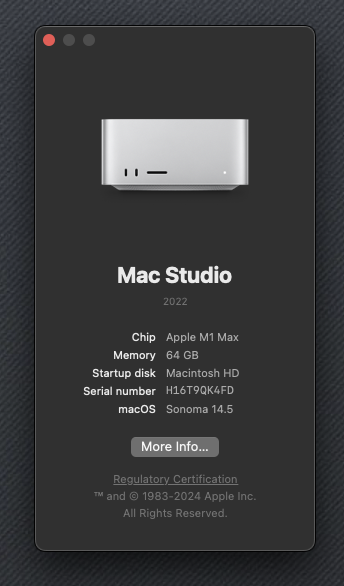

Okay... well... honestly everything is pretty much the same for me after installed 14.5 Public Beta. Everything that was working seems to work so far. What was broken still seems broken.
As far as the Steiinberg stuff crashing… that’s still happening.
Also, my Console 1 problem with the On Screen Display app is still going on. 14.5 Beta had no effect. Yeah… if this is something Apple needs to fix than some of us Console 1 users are really screwed. I’ve already setup a Keyboard Maestro macro when I hit F14 it opens the Console 1 OSD app, then checks to see if the Mixing Board and Sequence Editor are open. If they are it closes them. Hit F14 again, it closes Console 1 OSD and then reopens the Mixing Board and Sequence Editor. Yeah… it’s a pretty lame workaround for a lame situation. This is what I have to do now.
As far as the Kontakt issues, I wasn't experiencing them before so it may still be some sort of M2/M3 thing, and since I'm on M1 I wouldn't be able to tell if 14.5 did anything or not. Sigh...
