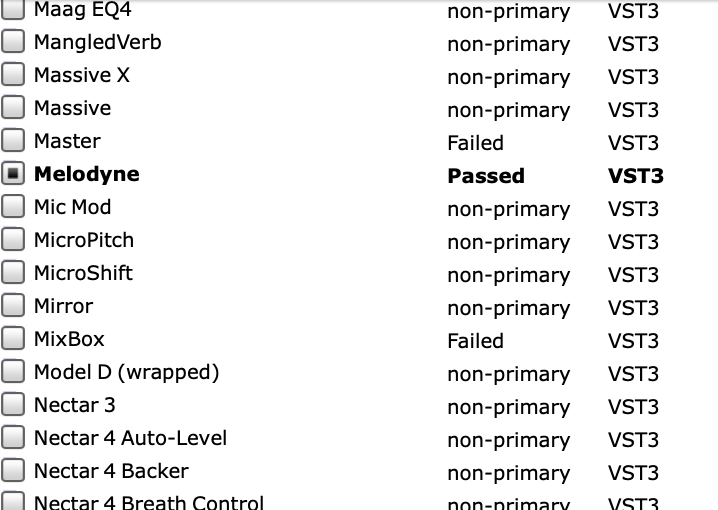

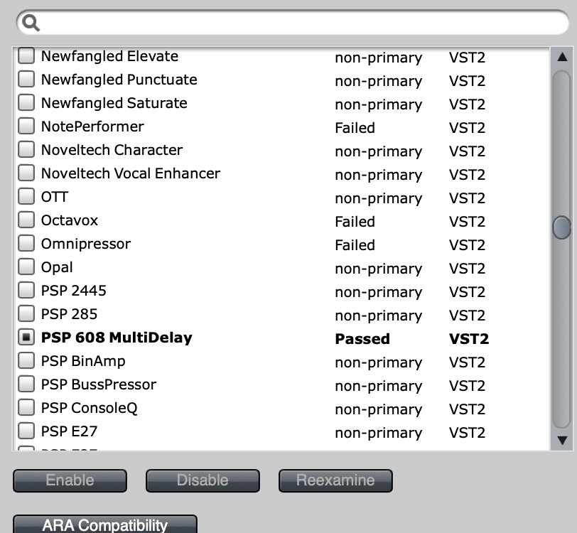

I don't have a problem with it. In my case, the AU version of the PSP 608 Multi Delay does not work but the VST2 does.James Steele wrote: ↑Fri Apr 05, 2024 3:40 pm Just so I'm clear on this, in the Mac world, AFAIK, in order to run VST2 and VST3 simultaneously, you must run DP in Rosetta, otherwise only VST3 will work. This because unlike AU, there is no support in MacOS to run Intel VST plugins individually. Am I mistaken?

- Screenshot 2024-04-05 at 4.09.51 PM.png (147.24 KiB) Viewed 2069 times
- Screenshot 2024-04-05 at 4.11.04 PM.png (90.95 KiB) Viewed 2069 times
