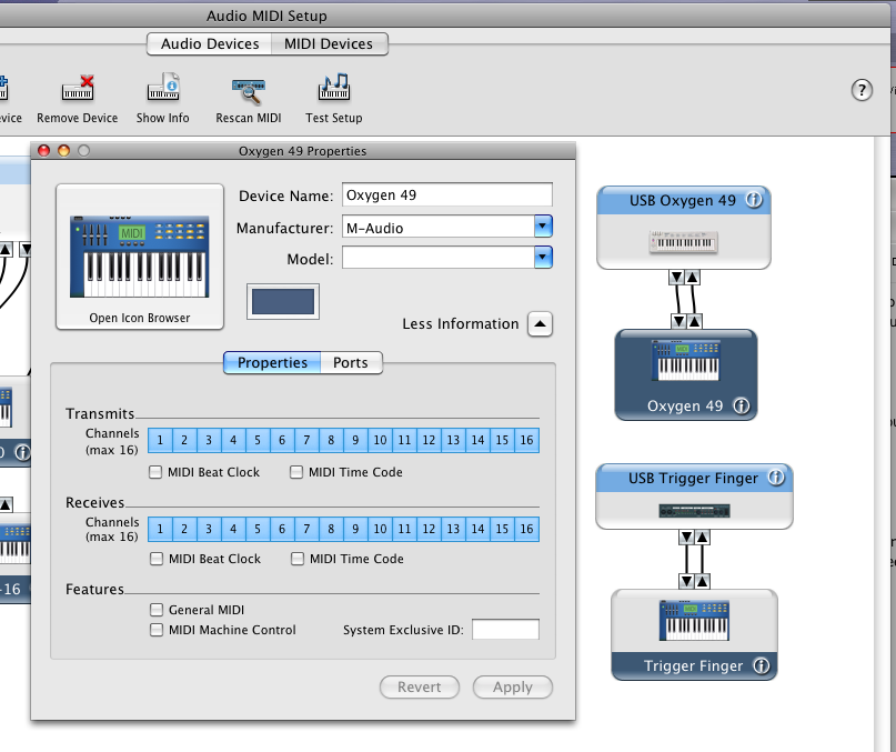

Look at my second post in this thread: https://motunation.com/forum/viewtopic.php?t=30997darrell wrote: ↑Sat Mar 30, 2024 1:39 pm Hi all,
My Axiom-61 keyboard (M-Audio) is not showing up in Mac Audio MIDI Setup, so won't talk to DP. That is, the keyboard will show as 'new external device' in the MIDI Configuration Window, but M-Audio does not appear in the manufacturer pulldown menu.
Any ideas about what' happening?
DP 11.3 running on Sonoma 14.3.1
Thanks!
Darrell A.
It's from a long time ago for setting up the Axiom but it might be helpful. Especially the second post where I describe connecting the device that appears automatically via USB and a second device you create manually and then connect it up to the USB device. Here's a pic from the post:
