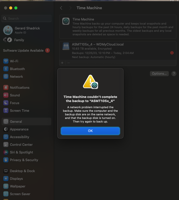

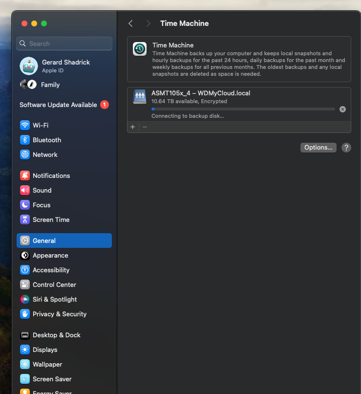

Still having issues using an external WD My Cloud USB drives for Time Machine back ups. Seems like there is an issue with Time Machine back ups over network. Does anyone have a Time Machine network back up working reliably with Mac OS Sonoma 14.1.1+ (either WD or Synology or other network back up solution)? Below is my last email to WD tech support but and I'm waiting for a call back from "Level 2" Tech support at WD. At this point I'm not confident that there is a solution to the issues I'm experiencing. I'm going to reformat these drives APFS and the just connect them directly to my Mac Studio via USB to get a reliable Time Machine back up.
"I discovered that WD My Cloud will recognize an external USB Drive only if it is under 16TB (same applies for WD HDD as well as HDD's from other manufacturers). However, Time Machine is still not working consistently. It will sometimes complete a back up after a restart but shows "connecting to backup disk" for several minutes or several hours (ref. screen shot attached). If and when Time Machine does run, it will often not complete due to a "network problem" (ref. screen shot). I'm running Mac OS Sonoma V 14.1.1 and My Cloud. Based on forum posts My Cloud no longer works with Time Machine Ref Western Digital Community link: https://community.wd.com/t/time-machin ... ore/274644 Can you please confirm and/or advise if there is a fix?
Thank you for your assistance"

tbwnm wrote: Mon Jan 08, 2024 11:30 am
My TM backups are absolutely rock solid with both my MyCloud EX2 Ultra and the old MyCloud Mirror. The EX2 has a pair of 5400 14TB WD Red HDDs in a RAID 0 array.
The Mirror is not being used by my Studio since it has only 6TB drives JBOD but I could post that screen shot from my wife's, too if needed.

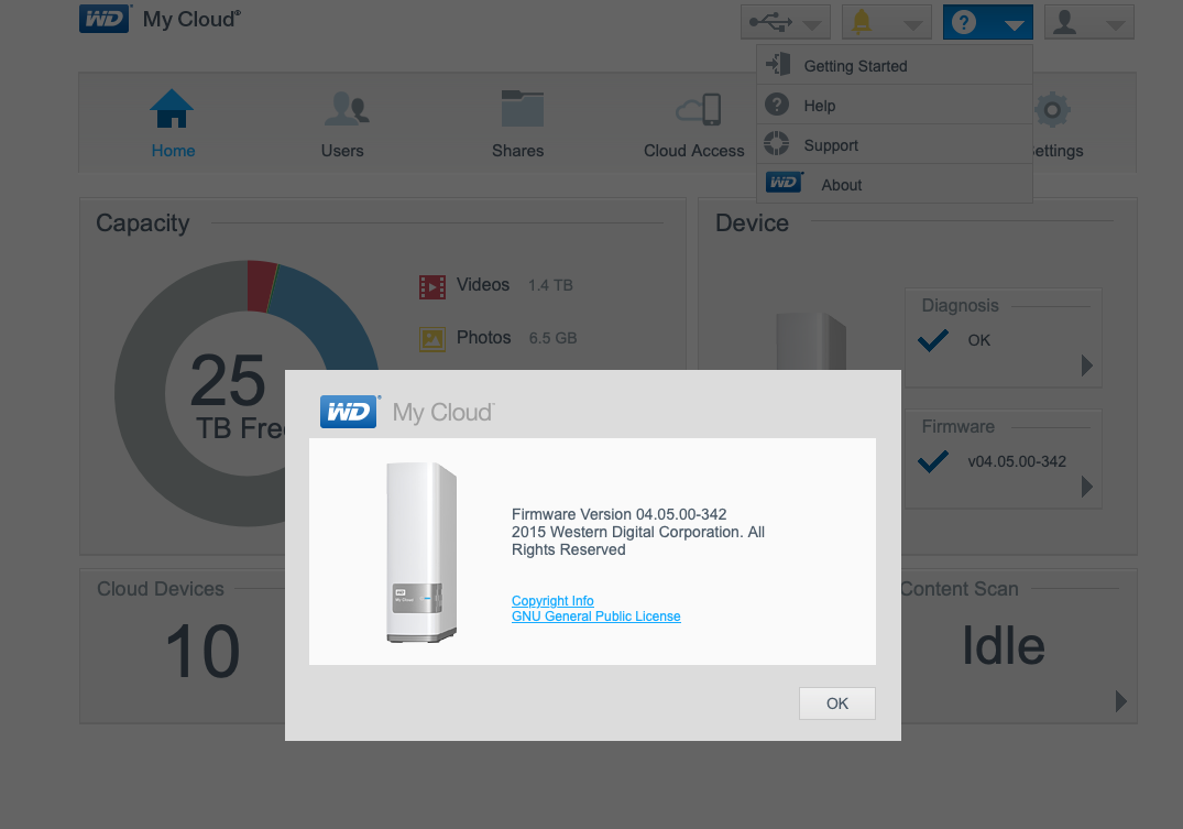

I'm using an older version of My Cloud than the EX2. Is your EX2 running the same firmware as mine v04.05.00-342 (ref. screen shot below)? There are no additional firmware updates available for my hardware version of My Cloud that I am aware of.
Reconfiguring WD Time Machine access as "Guest" vs "Registered User" also didn't resolve this issue and it kicked up a "The backup disk may have been ejected or disconnected from the computer:" error.
In general since I have tried to not just use WD My Cloud as a server but to also configure it to run Time Machine from an external USB drive, the interface is running very slow overall. For example, when I log in via the web browser it takes about 15 minutes to update the WD status and show the whole configuration and when there is any other activity (such as transferring a file or if the unit is running a "Safepoint" back up) it slows down even more. While I expect some performance hit when additional tasks are running, it pretty much grinds to a halt. I think this is why the Time Machine backups either don't run at all, are delayed or don't complete (I would say about 20% of the time I do get a confirmation that a back up has run but given all the issues I'm having I'm not confident of the integrity of these backups). For example, I just restarted the my Mac Studio and the back tried to run and was then "delayed" (Ref. screen shot). I have reached out to WD tech support again.
