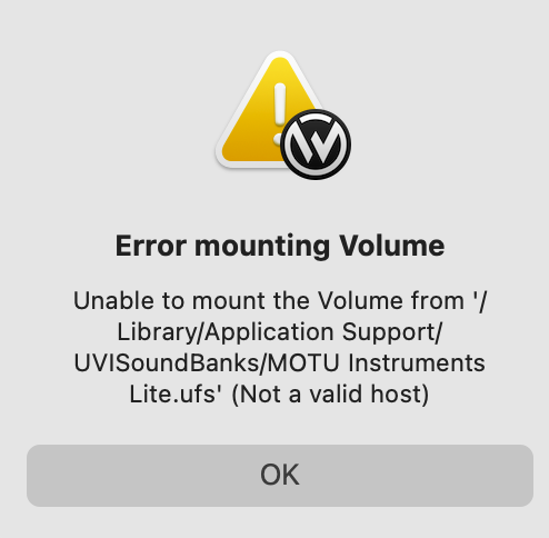

Thanks. Found the problem:
The build that I had installed was dated January 10, 2019. The one in Downloads is June 14, 2019. That one opened correctly.
This leaves another that I suspect might not be an error. I'm guessing that MOTU Instruments Lite.ufs can only be opened from within Performer Lite and DP (I can access it when I open PL projects in DP.) and not Falcon or UVI stand alone. I'll send in a TechLink and ask. Unlike MOTU Instruments.ufs, it does not require an iLok. Likewise, the chances that I would ecer want to do so are about zero.

mikehalloran wrote: Fri Jun 30, 2023 4:52 pmI'm guessing that MOTU Instruments Lite.ufs can only be opened from within Performer Lite and DP (I can access it when I open PL projects in DP.) and not Falcon or UVI stand alone. I'll send in a TechLink and ask. Unlike MOTU Instruments.ufs, it does not require an iLok.
That would make total sense the that the "Lite" version would be crippled to only work in Performer Lite and DP. Especially since it doesn't require an iLok. I imagine relatively new users that would use Performer Lite would be prone to passing it around and sharing it if it didn't have limitations on it.
