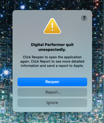

When I close a project, DP asks me if I want to save the project, I click "yes," and poof! The whole program crashes. Every time.
The crashes are always followed by one of these messages:
Is this happening to anyone else?
