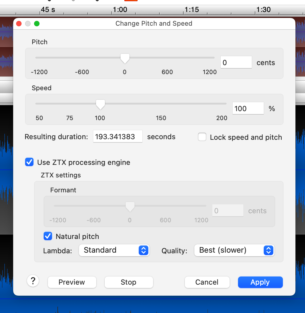

Interestingly, I don't think you can lock length and pitch together in DP (?!?!).
You can by checking a box in TwistedWave, however.
With Pitch, 0 is unchanged. For Speed, 100% is unchanged, you can do one, the other or both. Checking Lock simulates analog tape behhavior.
