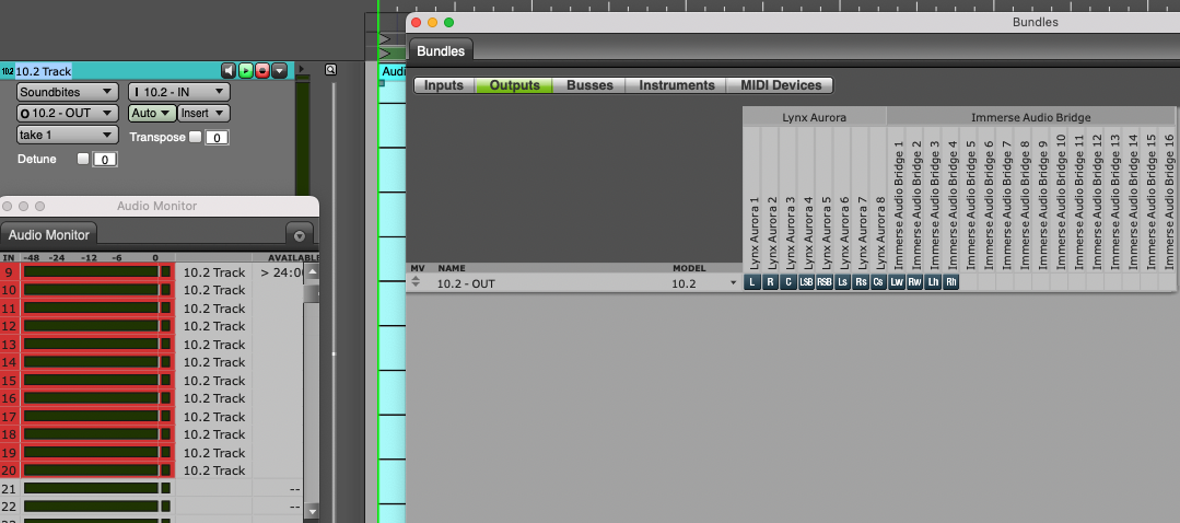

Oh. There's already a virtual device in my system that allows for more outs than I physically have on my 8 ch Lynx Aurora n. Is this anything like what you're after?
- Screen Shot 2022-07-23 at 1.42.53 PM.png (265.35 KiB) Viewed 3147 times

Re: Dolby Atmos
I was able to get past hardware requirement, by adding another audio interface that I no longer use...but at least I could create a 5.1 bundle with those existing.
Now on to next problem. What is the proper way to setup a surround mix bus in DP? I created a bundle and assigned that to the master channel output...ok.. I see more meters..must be active...But here is the problem, the intention is to use binaural monitoring, which means the 5.1 bus needs to feed a binaural plugin (in my case I will use dearVRmonitor for this task. In the other daws, I simply put dearVRmonitor on the master bus. This converts the 5.1 (6 channels of audio) into two channel binaural, which can then be monitored with headphones quite effectively. However, the problem in DP is that it won't even let me put that plugin on that master bus when the master bus has been assigned to a 5.1 bundle output. I think its because it sees the dearVRmonitor plugin as being "stereo". Somehow on the other DAW's, they are able to see it as something that can be inserted, but DP won't let me insert it to the 5.1 channels...only to stereo channels...but that defeats the purpose.
Somehow I need to be able to mix all my instrument channels as 5.1 panning...sent to some bus, where I can insert the dearVRmonitor plugin to convert the 6 channels of 5.1 into 2 channel binaural. Its easy in LogicPro and cubase...but it seems so far impossible in DP. I have tried various different things, trying to create some AUX channels, etc. but DP just keeps getting in the way and I'm of the opinion right now this is simply not going to be possible in current version of DP11.
Does anyone have any experience with anything here that might know what to do? I think the same problem must exist for those using Dolby Atmos tools in DP...if anyone actually is. Its a similar process whereby a 5.1 or 7.1 master bus needs to use the Dolby rendering plugin to generate either binaural or Dolby Atmos, etc. I don't know..
Anyway, any suggestions welcome. 7.1.4 would be better, and DP isn't there yet. But 5.1 could also be pretty good for me if I can get this to work...otherwise I will have to relegate all surround mixing tasks to other DAW's and just use DP for the MIDI part of the process..
