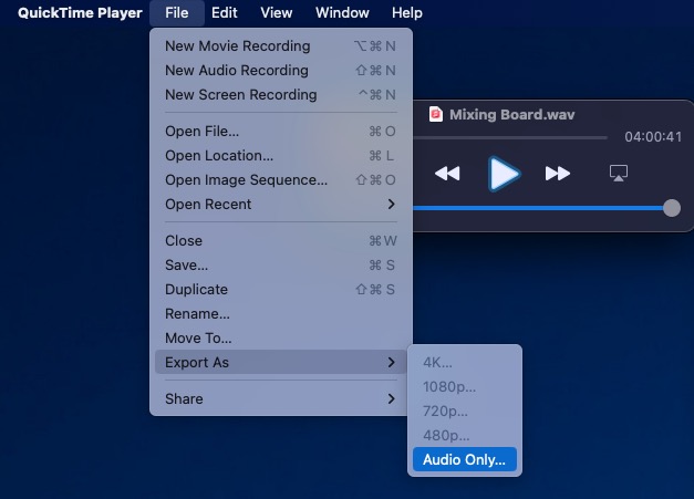

FYI, just to double-check, I just tried importing from the portable SSD drive above again (it's pretty fast). The same error occurs.
The 4+gig WAV file only imported when it was trimmed to less than 4 gig or when it was converted to another file type and the conversion resulted in a file less than 4gig. This seems to indicate the problem is importing a 4+gig WAV file into DP. Every that requirement is reached, the error occurs.
To get the project done, I converted the WAV file, imported the under-4gig resulting file, and the project is now done - didn't have time to call MOTU today.
If anyone else is having this problem and has figured it out, please chime in.

It appears that you may be dealing with corrupt audio headers. DP has a very low tolerance for that. Instead of trimming the file, try rewriting the header. You can do this in Quicktime — convert .wav to .wav or to .aif and back to .wav. The raw audio will be untouched. There are studios that send me files where I have to rewrite every one before it loads into DP — been dealing with them 20 years now and a batch convert of a a hundred gigs takes a few seconds using TW.
QT works fine but, if you do many, there are other utilities that are faster including Twisted Wave and DSP-Quattro.

Re: DP OS error disk is full (-34)
Please post screenshots of Quicktime converting audio as you described, including version of Mac OS and version of Quicktime you're using -- I ask because what you're describing apparently isn't an option in QuickTime 10.5 on OS 13.3.1mikehalloran wrote: ↑Tue Apr 18, 2023 8:32 pmYou can do this in Quicktime — convert .wav to .wav or to .aif and back to .wav. ....
- Screenshot 2023-04-19 at 9.32.43 AM.JPG (40.77 KiB) Viewed 1164 times
- Screenshot 2023-04-19 at 9.33.47 AM.JPG (31.97 KiB) Viewed 1164 times
