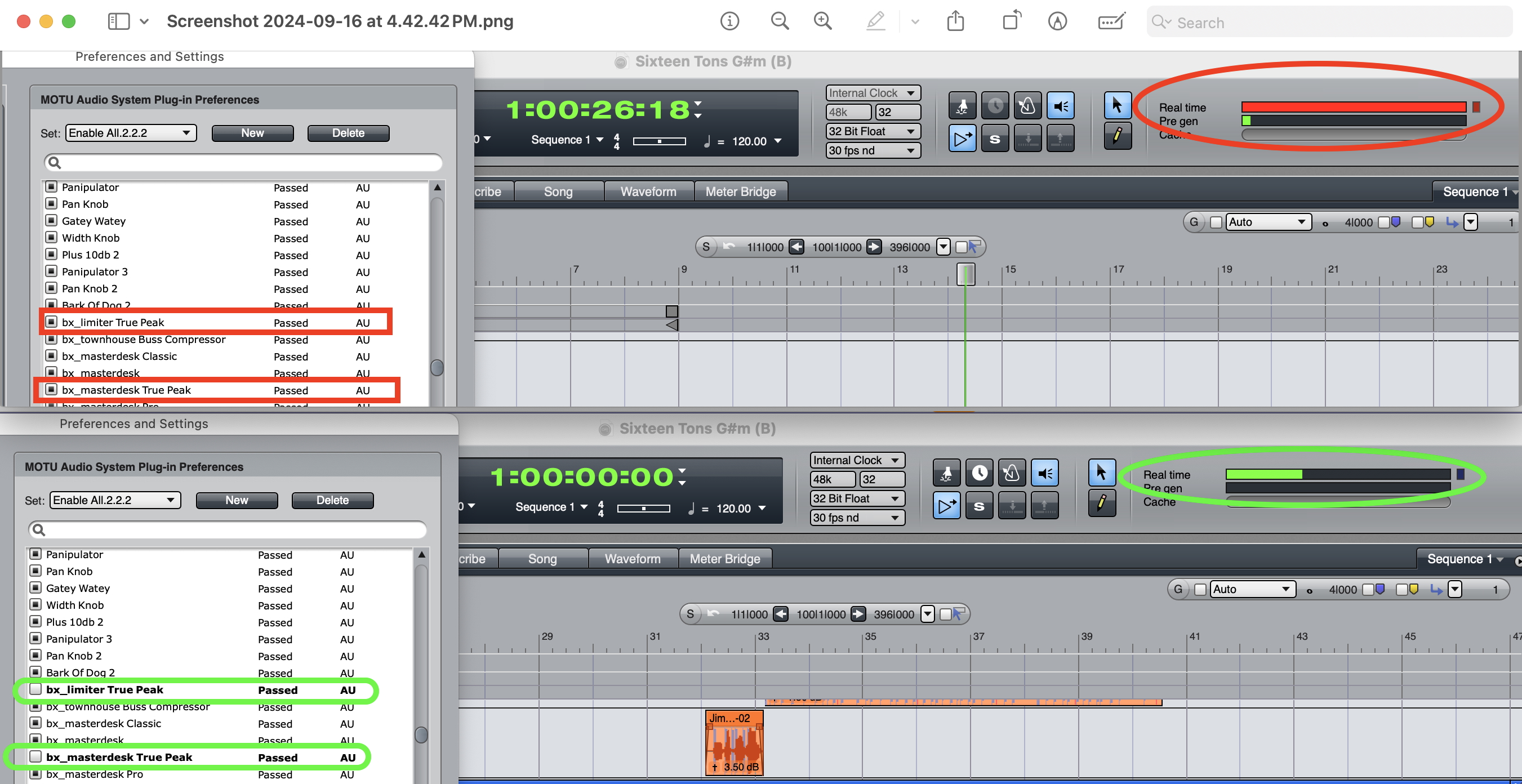

One of my bread & butter plug-ins, bx_limiter_True Peak is giving me grief—same issue they had to fix over Sonoma last year. Bug and test reports sent in as I find them.

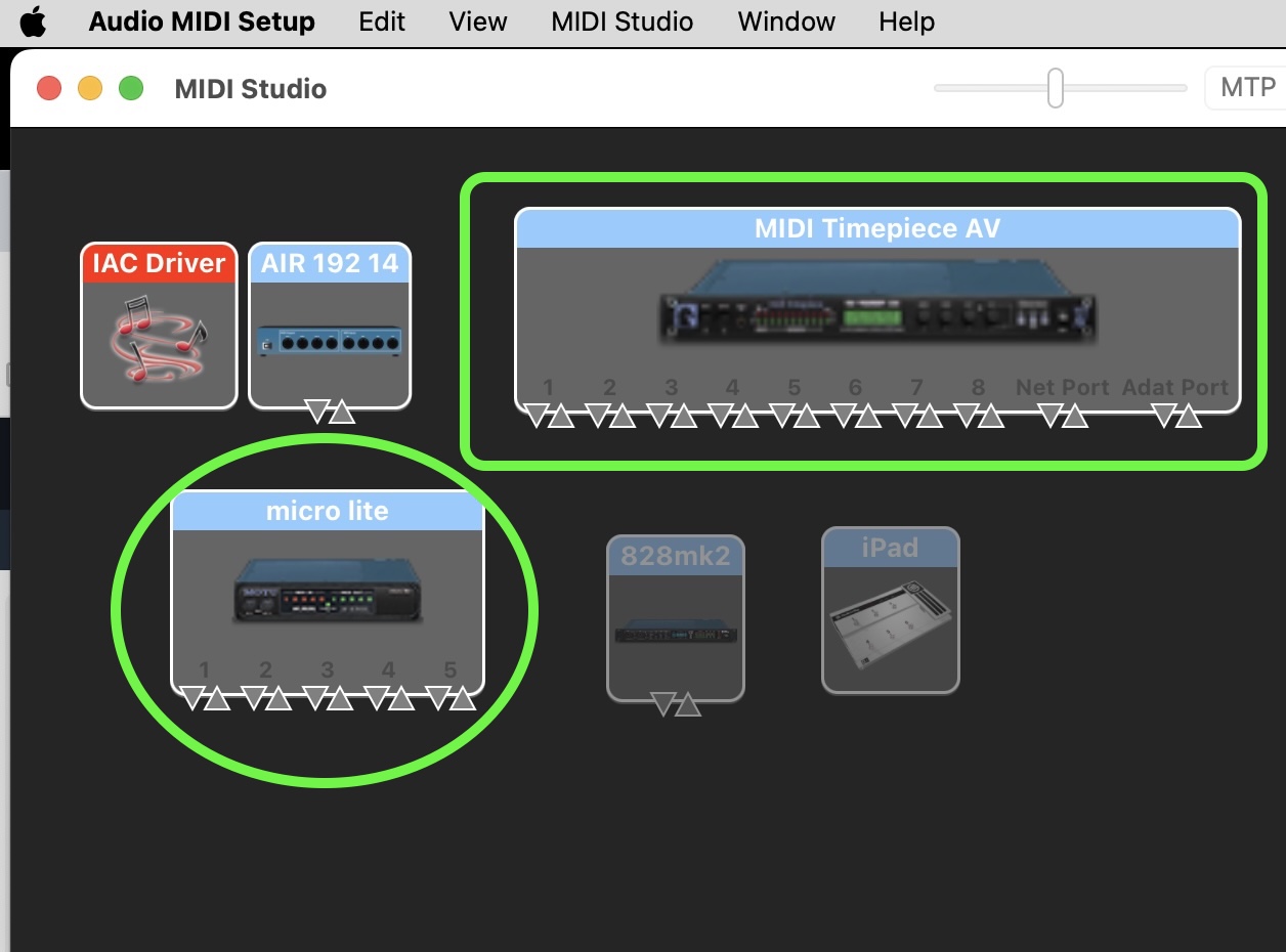

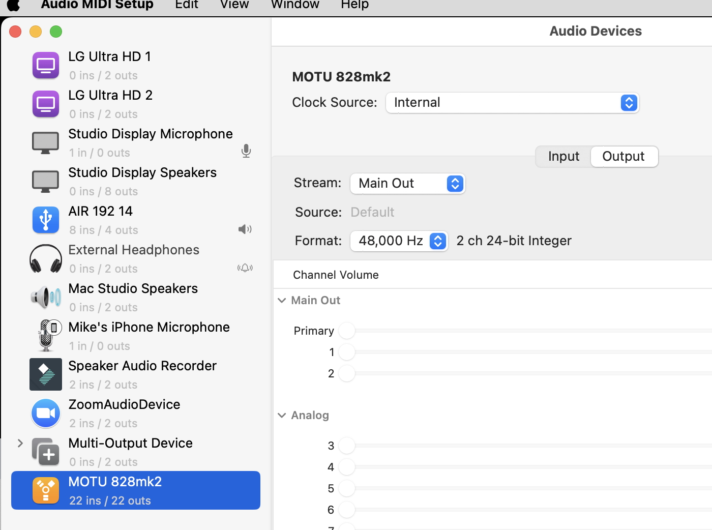

I have my 828mkII FW and my MTP AV & micro lite units running just fine over Sequoia. Since both were fresh installs, zero problems. As with Sonoma, the MOTU MIDI driver must be installed first, then the Audio driver.
With Apple Silicon, the Audio driver will not work if booted from an external drive as certain .kxt files will not load; not a problem with the MIDI driver. It's an Apple issue for which there is no workaround. APFS Volumes on the System drive only.
Pictures or it isn't happening, right?
