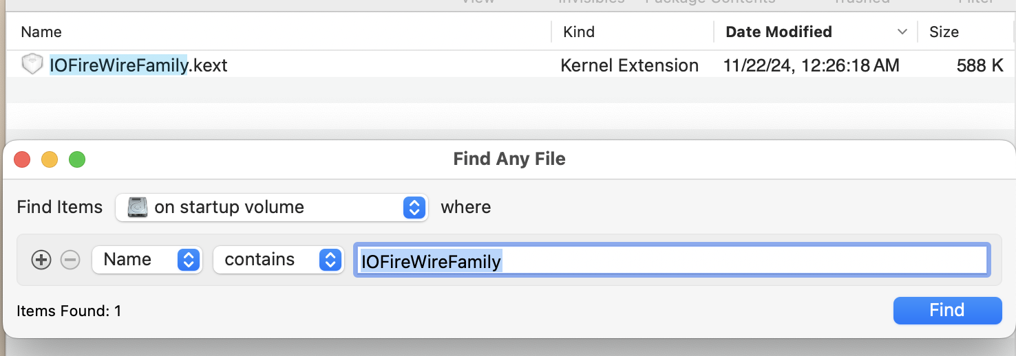

Phil O wrote: Sat Dec 28, 2024 8:56 am So I read in a discussion that firewire audio support has been removed from the .kext but cameras, scanners, etc. still work. I don't know if this is true, but it would explain what I'm seeing.
But why would they do that?
It's not true. If it was, then our MOTU FireWire devices would no longer work, either. My screen shot showed my 828mkII FW working just fine over Sequoia 15.1.1.
Here is a FindAnyFile screen shot from just a few minutes ago. The November 22 modification date is found in both the Sequoia 15.2 and Sonoma 14.7.2 builds of the macOS.

Thanks so much for that, Mike. I did a search for IOFireWireFamily.kext and couldn't find it anywhere. Then I updated to OS 15.2 and it appeared in System>Library>Extensions. A quick browse of Time Machine showed that it was not there prior to the 15.2 update. When I get a chance I'm going to try my Apogee unit again.
