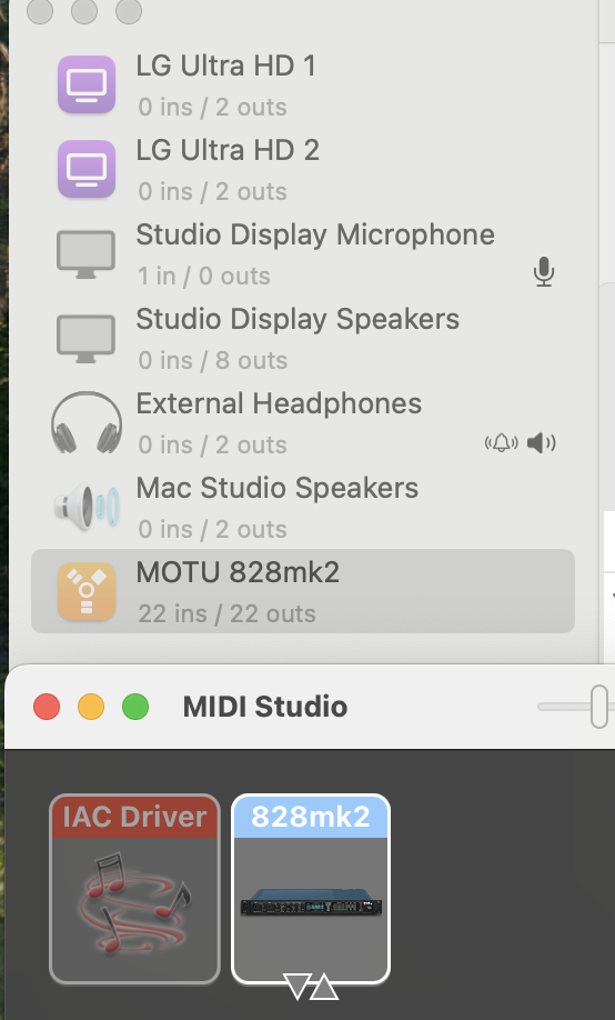

My 828mk2 FW is fully functional over Sequoia. I have screen shots on my Mac when I get back to it.

Here's that screenshot showing the 828mkII FW. Both Audio & MIDI are working over Sequoia 15.1.1
